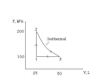

One mole of an ideal monatamic gas at an initial volume of 25L follows the cycle shown below. All the processes are quasistatic. Find the efficiency of the cycle.

Firstly I calculated the temperature at each stage using the first equation. I found the first temperature to be 301K and the next two to be 601K.
For the constant volume and the constant pressure stages I calculated the heat flow using the second and third equations. I found Q12 to be 3700J, and Q31 to be -6200J.
For the isothermal portion heat flow is equal to work done by the gas which I found to be 3500J (so 3500J is flowing into the gas and the gas is doing 3500J of work).
For the constant volume portion the work done is 0 and for the constant pressure volume the work done on the gas is pressure times change in volume (-2500J).
To calculate efficiency I divided the net work done by the gas by the net heat flow into the gas but the answer is 99.9%. Can anyone spot where I have gone wrong?
Thanks a lot.

I am not sure how you got 99.9%. The net work is the area inside the path. That is 1000 J. (3500-2500 but which is also Qh-Qc = 7200-6200 = 1000). The efficiency is:
[tex]\eta = W/Q_h = 1000/7200 = 13.9[/tex]%
If you are using the net heat flow, Qh-Qc, in the denominator you will always get 100% since W = Qh-Qc.
AM
Ok. I now know where I went wrong. I got the same value for W but I divided it by the net heat flowing into the system (ie 3700 + 3500 - 6200) instead of Qh.
Thanks for your reply.
