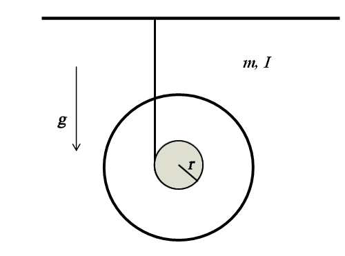

A yo-yo has mass 0.8 kg and rotational inertia 0.12 kg m2 measured about an axis perpendicular to the screen and passing through its center of mass. A light thin string is wrapped around the central part of the yo-yo that has radius 0.03 m. The string is attached to the ceiling as shown. The yo-yo is released from rest and begins to descend as the string unwraps.
Use conservation of energy to find the linear speed of the yo-yo by the time it descended a distance 0.8 m. Use g = 9.8 m/s2.
Used conservation of energy :mgh=.5mv^2+.5Iw. w=v^2/r^2. v=3.74.
What am I doing wrong?

Is the question to find the vertical velocity? At what distance fallen? You really should quote the entire question exactly as it is given to you. If you have, the answer cannot be found.
Which radius did you use in w=v/r ?

The attached diagram does not belong to this problem either - it's missing at least one force.

What is the radius of the entire yo-yo?
The whole thing has rotational K.
The radius is .03.
That is the inner radius where the string is tied according to the diagram.
Can we say that the radius of the entire yo-yo is R?

You are given the rotational inertia. Since the problem does not state what type of extended mass the yo yo is we need the radius. Are you looking at the correct diagram?
The diagram is correct, and the problem doesn't give us the radius of the entire yo-yo.

The problem states the rotational inertia of the entire yo-yo so use that. From the first post in thread:

The problem states that the yo-yo has rotational inertia I = 0.12 kg m^2. There's no need to find the radius of the yo-yo, and that wouldn't help unless you knew how the mass in the yo-yo was distributed.
There's also a typo in your equation (you left out the ^2 for w^2), which should be:
m g h = .5 m v^2 + .5 I w^2

Here's my calculation
mgh =.5mv^2+.5Iw^2
2gh = v^2 + .12*v^2
.62v^2=2*9.8*.8
v^2 = 2*9.8*.8/.62
v=sqrt(2*9.8*.8/.62)
mgh =.5mv^2+.5Iw^2
2gh = v^2 + .12*v^2
In this step you lost the I and forgot to divide the second term on the right by m. Also, you replaced w with v, when it should be w = v/r.

After multiplying your first step by 2 and replacing w with v/r you have
mgh = v²(m + I/r²)
Dividing both sides by the brackets solves for v².

v^2=(mgh)/(m + I/r²)
you left out the .5's
v²=(mgh)/(.5 m + .5 (I/r²))
v²=(mgh)/(m+.12mr²/r²)
You multiplied the inertia term by r^2, the equation should still be:
v² =(mgh)/(.5 m + .5 (I/r²))

The moment of inertia of the yo-yo I = .12 kg m^2 (where m is meters, not mass). The radius of the yo-yo is already taken into account for this stated moment of inertia and is not related to the radius of the central part that the string unwinds from. So just continue from here:
v^2=((.8)(9.8)(.8))/((.4)(.5*.12))
v=((.8)(9.8)(.8))/((.4)(.5*.12))^.5=16.1658.
