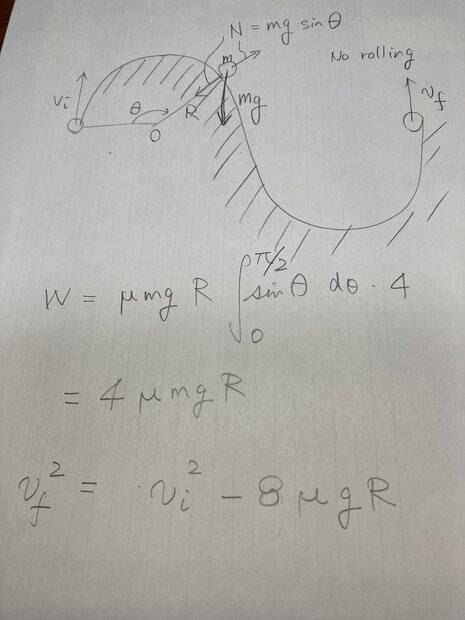

I take it easy as sketched.
##N=mg~\sin\theta~## "as sketched" only if the mass is at rest at each point on the track. Otherwise, it is what is necessary to provide the observed acceleration.
  • #45
kuruman said:
N=mg sin⁡θ "as sketched" only if the mass is at rest at each point on the track. Otherwise, it is what is necessary to provide the observed acceleration.
In order that we can neglect centrifugal force in N, the condition
[tex]g >>\frac{v^2}{R}[/tex]
should be necessary.
[EDIT] Now I perceived under this condition the ball cannot overcome the top where potential energy mgR < 1/2 mv_i^2 initial kinetic energy. So this is not the case we are looking for.
[EDIT2] I further recognize that the ball leaves the slope in my ball and bamp model. The ball just go straight up with initial velocity leaving the slope, stops and falls. How the ball is constrained on the designed trajectory ? Friction takes place between ball surface and WHAT ? I am afraid there is no generic answer to this problem but are specific answers according to these conditions given.
  • #46
So how would you write Newton's second law? If the mass is to follow the semicircular paths, its direction is changing continuously. If you ignore the centripetal (centrifugal if you prefer) force in N, then the direction of the velocity cannot change. Maybe I don't understand what you mean so please write Newton's second law for the part of the motion when the mass is where you show in your diagram.
