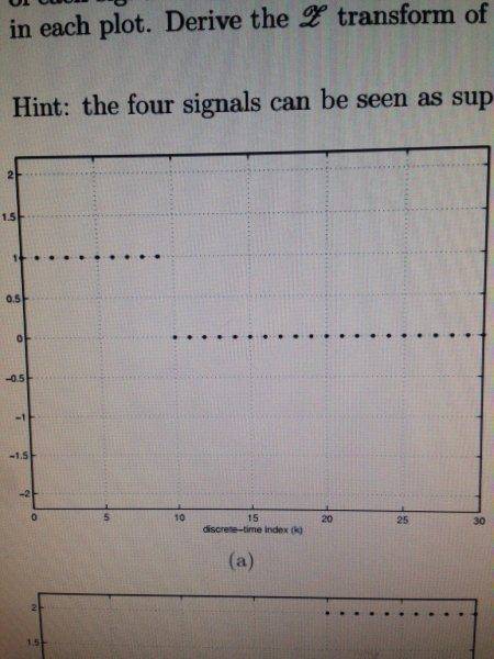

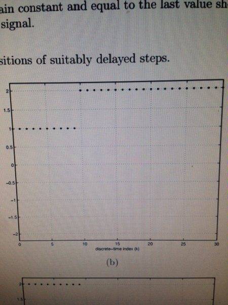

The Plots bellow show two discrete time signals, in the plots only the initial proportion is shown. Then the signals remain constant and equal to the last value shown. Derive the Z transform of each Signal.
Plot of a discrete-time signal in panel (a): value 1 for indices k from 0 to 8, then value 0 from k=10 to k=30, with a dotted line trace on axes labelled discrete-time index (k).
Scatter-style plot of a discrete-time signal: dots at value 1 for k from 0 to 8, then at value 2 from k = 10 onward, with axes labelled discrete-time index (k) and 0 to 30.
The attempt at a solution
I can get part A, giving an answer of (z9+z8+z7+z6+z5+z4+z3+z2+z+1)/z9
I apply the same concept to the second image but I am getting lost and not getting near the correct answer of (1/z9)x((z10+1)/z-1)
Im very new to digital control, so I've potentially missed a key detail out of the question, so if i have let me know!
Any tips about how to go about this would be greatly appreciated

Are you sure its (1/z^9)x((z^10+1)/z-1) and not (1/z^9)x((z^10-1)/z-1)
I get to the Z^10 - 1 answer 2 different ways.
I'll describe the process and let you do the maths (I'd suggest doing it both ways for practice)
First way: You have a series of dirac's shifted. So using the dirac z Transform 1 and the shift property you end up getting 1+z^-1...+z^-9 (where you were in the first post)
From there you use the geometric summation formula and rearrange ending up (unless I made a maths error) with (1/z^9)x((z^10-1)/z-1)
Second way you as Miles said notice that the series is a combination of 2 step functions (which ones though?)
then you use the transform for the unit step, shift property and linearity property and you'll end up with X[z] = A + B rearrange and you'll end up at the same result (sorry I suck at latex lol)
Are you looking at (a) or (b)? It's correct for (b).

Ok thanks for that, I am starting to get there now i managed to get the answer you go of (1/z^9)x((z^10-1)/z-1) for part A, however its the fact that the step goes up to 2, in part B that's throwing me, here's what I have done so far, am I on the right track? (Its a picture as it takes me forever to type in the equations :P )
Handwritten z-transform working: Z{u} = sum from k=0 to infinity of u_k z^-k, with u_k = 1 for k = 0, 1, 2, ..., 9 and u_k = 2 for k >= 10, expanded as a series of terms |z^-0 + |z^-1 + ... with a 2z^-10 term onward.
I remember having issues with the infinite sums like what you're trying to do in part 2.
Can question 2 be put in terms as a linear combination of 2 other functions?
