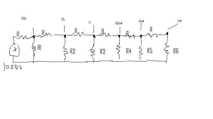

I attempted to start the design of this ladder but I am not sure how to choose my resistances so that the equivalent is the 1 Mega-ohm. Also, what do they mean in part B of this question by shunting the resistances into a 3 to 1 ratio?
This is my attempt so far at the design. Am I on the right track? I am kind of confused here.

Have you covered any "canned" methodology for designing resistor ladders in your coursework? If not, there's going to be a bit of number crunching to do.

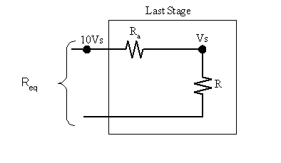

I'd start at the tail of the ladder and work back towards the voltage source. The last section is a simple voltage divider, so assign R to that last resistor and 9R to the second to last one (the final horizontal resistor). That'll give you a 10:1 division of the voltage presented by the previous stage. For purposes of design, just assign 1 Ohm to R for now.
Next you'll have to work out an algorithm for building the previous stage. You have a voltage division constraint (divide by ten) and a current division constraint (3 to 1), along with the resistance of the already chosen tail stage. Keep track of the total resistance as you work back, stage by stage.
When you're done you'll have filled in place-holder values for all the resistors, and will have the total resistance as seen by the source (since you kept track of it as you worked back). The total resistance won't be 1M Ohm. Can you determine how to scale the resistance values to make it 1M?

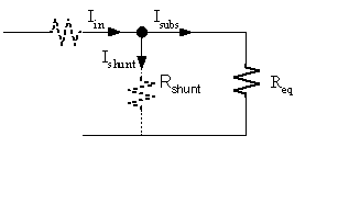

Presumably the criterion in (B) means that each shunt resistor will be three times the equivalent resistance of the rest of the network. In this diagram Rshunt is part of a new stage being added. Req is the current equivalent resistance of the stages to the right of this new construction.
So that Isubs = 3 x Ishunt. This forces the choice of Rshunt.

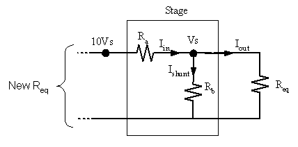

You can build a single ladder incorporating all of the criteria. Start by designing the final stage, which is simply a voltage divider that takes the next to last stage's voltage and divides by ten. Big hint: For now, assign a value of R = 1 Ohm to the final resistor. That'll be the value that all other resistors will scale to.
Next see what has to be done to add the next stage. For example, the shunt resistor has a requirement based upon the current division spec. How can you enforce it by choice of the stage shunt resistor? The new stage is a voltage divider, too. So how can you choose the resistor value for Ra?
