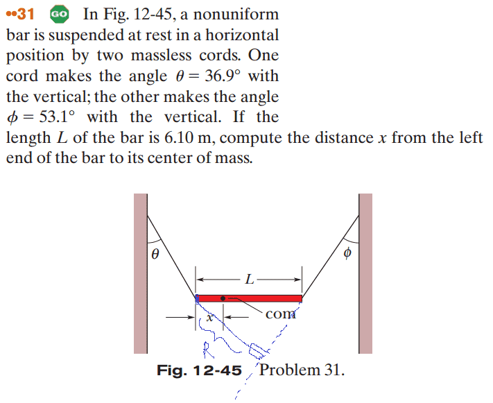

How do you determine 'r' in Torque calculations?

Physics diagram of a nonuniform horizontal bar of length L hung by two cords from walls, one at angle theta and one at angle phi from the vertical; the center of mass is marked com and distance x is marked from the left end, with handwritten annotations below the bar.
Torque = r * F * sin(x)
The solution says that the 'R' I marked was L*cos(phi). I fail to see the geometry of how they got this...you have only one side and one right angle for that triangle...how can you solve for 'R'?
You should be able to find the other angles, for example between the right hand rope and the bar.
