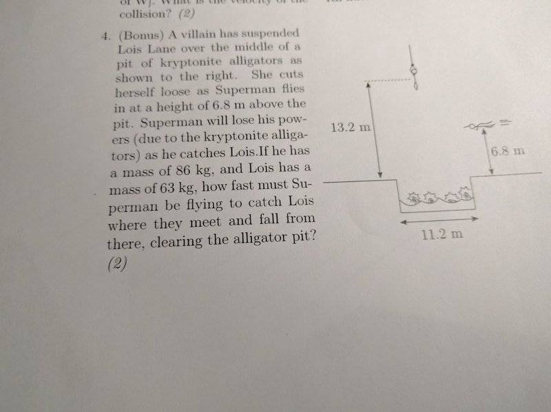

Question is on the attachment photo.
I tried to create an equation but I didn't know the momentum for each of the people in the scenario because none of them have a given speed.[/B]
I just need the velocity of Superman to solve the problem. How do we find the speed?[/B]
  • Diagram of a pit with alligators at the bottom, showing a height of 13.2 m from the top of the pit to a suspended point, a height of 6.8 m above the pit edge, and a pit width of 11.2 m, with Superman flying in at the right.

How far will Lois have fallen when she is caught?
It has to be the difference between the 2 heights. 13.2 - 6.8.
