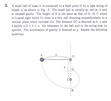

For number 3,4,5
https://s4.postimg.org/qbp3xzq65/IMG_1092.png
https://s22.postimg.org/u220j60sx/IMG_1093.png
Centripetal force = m v^2/R
T = centripetal force + w
Sigma F = m.a
Number 3. Find the v at D point using mechanic energy eternity
While kinetic energy at A point is zero, and the potential energy is max (height max)
So, 1/2mvD^2 + mg.hD = 1/2mvA^2 + mg.hA
i don't know the height at D point...
After i find the v at D
I can find T
Which T = centripetal Force + weight
T = mvD^2/R + m.g
Number 4 almost the same
The string doesn't bend (what exactly it means...?)
So, centripetal force > weight??
m.vD^2/R > m.g ...(1)
But why the centripetal at point D has opposite direction than weight force? Is it because the string stuck at the nail at C point??
Find the v at D using mechanical energy eternity then add v to ...(1)
Number 5 i still don't know...

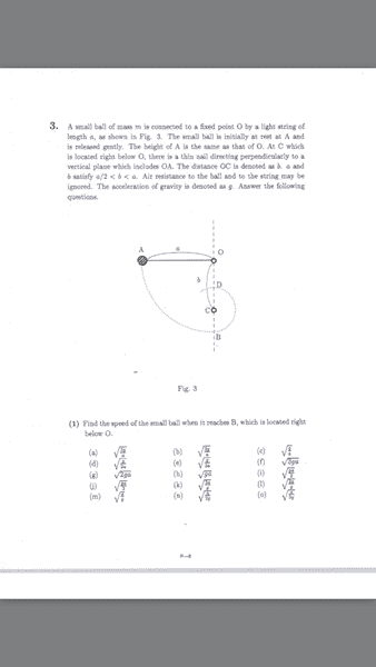

Hello Helly, :welcome:
Unfortunately your pictures don't show up in your post. I get:
Can you try again ?
Can you try again ?
ok.. thanks for report. I've changed the pic.. :)
with ##v_A = 0 ##.
make a sketch of the situation and you know it. Note that CB = CD.
You know the length of the string, and you know how far C is below A. How far above C is D?
is the height of D start from C or B ...?
CD = a-b
BC = a-b
if D start from C then height of D = a-b
if D start from B then height of D = 2(a-b)
Check your energy conservation equation: If A is at height zero, you must take height of D wrt the same referernce.

Do you realize image 1093 is extremely fuzzy ?

No the problem is idk the speed.. And not sure the height of D. If the string not bend, it's possible if only the string stuck at nail on C point then goes around to D, it means the height of D is a-b. The v^2 at D = 2gb.. Then.. I don't find the answer match the options
with respect to what reference point ?
Helly123 said:
The v^2 at D = 2gb
How do you calculate that ?
Do you know the answer already?
CB = a-b
CD =CB
CD = a-b.
Suppose a is 0.5 m and b is 0.4 m. What is the height of D ?
What is the formula for the height of D with your reference point O = 0 ?
Since the ball goes around to D point, the reference i used no longer O=0 but C.. Cuz the T is at C.. No i used is at O the height is a (max)
we know that OC = b (0.4 m)
Then CB = a-b (0.5-0.4)m
Then CB = 0.1m
CD = 0.1m. Then use CD as height of D
