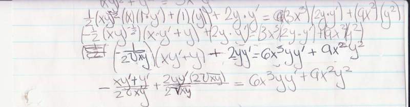

find the derivative of ...
(sqrt(xy))+(y^2)=(3*x^3)*(y^2)
it has to equal to y'
(-1/2(xy)^-1/2)(xy'+y)+(2yy')=(3x^3)(2yy')+(9x^2)(y^2)
i got stuck. idk how to get to y' ?

thats what i did. what did i do wrong.?

do you understand what i wrote? my handwriting is horrible. sorry.
No, that looks right.

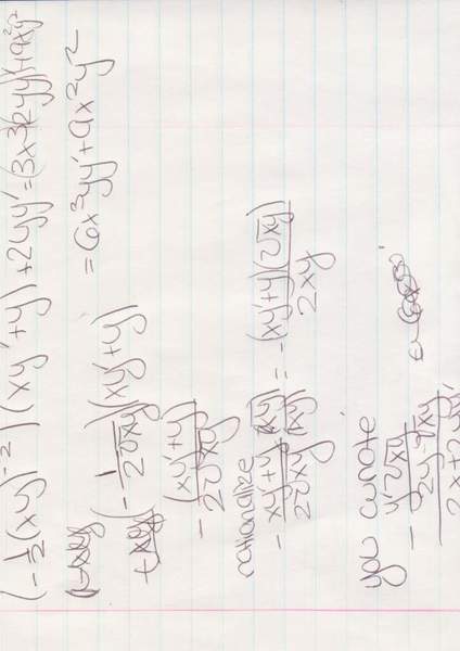

im sorry i fixed it. this is where i got stuck.

The first thing at the bottom should be (xy' + y), not (xy' + y').

First, it is not "-1/2". The derivative of [itex]x^{1/2}[/itex] is [itex](1/2)x^{-1/2}[/itex]
so this would be [itex](1/2)(xy)^{-1/2}(xy'+ y)+ 2yy'[/itex][itex]= (9x^2)y^2+ 6x^3yy'[/itex]
Now combine the terms involving y':
[itex](1/2)(xy)^{-1/2}xy'+ 2yy'- 6x^3yy'[/itex][itex]= 9x^2y^2- (1/2)(xy)^{-1/2}y[/itex]
[itex][(1/2)(xy)^{-1/2}x+ 2y- 6x^3y]y'[/itex][itex]= 9x^2y^2- (1/2)(xy)^{-1/2}y[/itex]
and solve for y'.
