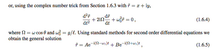

..when it is released from rest with velocity (v0, 0)
I can get 1.6.5 but I can't get this:

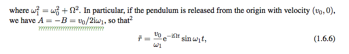

First, note that ## \tilde{r}(0) = A + B = 0 ##, because the pendulum starts off at the origin. This equation gives ## A = -B ##. Next, calculate the time derivative of ## \tilde{r} ##, evaluate it at time zero, and set it equal to ## v_0 + i(0) = v_0##:
## i[(\omega_1-\Omega)A-B(\Omega+\omega_1)] = v_0 ##.
But the only way this equation could be true is if
## (\omega_1 - \Omega)A - B(\Omega+\omega_1)=-i v_0 ##.
Do you see it? The rest follows by using ## A = -B ##.
