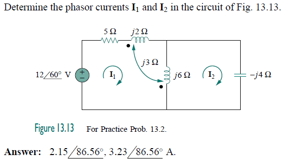

See attached.
(5+j8)I1-j6I2-j3I2-j3I1*2=magnitude(12) degrees (60)
(5+j2)I1-j9I2=magnitude(12) degrees (60)
j2I2-j6I1-j3I1=0
-j9I1+j2I2=0
I put these equations into mathematics software and get the answers:
I1=magnitude (0.3091) angle (142.60) degrees
I2=magnitude (1.3909) angle (142.60) degrees.
These are not the answers provided. Can somebody show me where the error is?

Can you show how you derived your equation? I'm concerned about how you treated the mutual inductance. Perhaps assign variable names to the component values for easy tracking in the equations.

You have a sign error. The equations should be:
(5+j8)I1-j6I2+j3I2-j3I1*2=magnitude(12) degrees (60)
(5+j2)I1-j3I2=magnitude(12) degrees (60)
j2I2-j6I1+j3I1=0
-j3I1+j2I2=0

Thanks for that. I had to go over some of the previous examples in the book. However I figured out what I was doing incorrectly.
