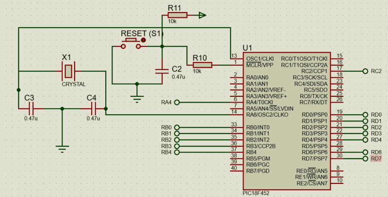

I am currently working with Proteus and MPLABX, coming from a physics background, i was always made to follow instructions to which electrical components to use, how many of them, and where to connect them, on the breadboard for experiments. Now I am dealing with PIC mirocontrollers and seek a deeper understanding.
I am aware of the functions of the components, but how do you KNOW when and how you should use them in a real circuit? without looking at already made examples.
The image i provided is a section of microcontroller circuit that i used to interface code in C with the I/O port of the microcontroller, in Proteus.
I have realized i was only ever told to learn how to measure the voltage and current across the components, Kirchhoff's rules and all, and respective component values through equations... but was never put to test on creating a circuit from scratch and made to decide on the component placements on my own.

why were capacitors placed in those specific positions with those values?
could you make the circuit simpler? or improve it?
What other components would you add to it?
Any extra info or source suggestions would be awesome.

On microprocessor oscillator and reset circuits like these, it's best to follow the recommended component configurations and values that are shown in the datasheet. I've written such directions, and they are there for a reason -- the external oscillator circuit will depend on the oscillator circuitry in the IC, and variations to the external circuitry can cause poor stability and poor tolerance in the oscillator's performance. Similarly for the Reset circuit, the external recommended circuit is based on the internal Reset circuitry and circuit timing, and should not be altered.
It looks to be a parallel resonant crystal oscillator circuit, with the current limiting series resistor inside the IC itself on the CLKO output.
To learn more about crystal oscillators, just do a Google or Wikipedia search. They are very interesting animals. :smile:

Experience. There's no way to know what to do without practicing and studying the given examples.
Interesting. For Atmel μC capacitors in the oscillator (C3 and C4 on your circuit) should be in the 18-22 pF, I wonder if 0.47 μF is not a mistake.
If I am right I will pretend it is "experience" ;)
Good catch! yeah, that's a huge value for a parallel crystal oscillator of any useful frequency. 47pF would be more reasonable.

The schematic that you posted (modulo the capacitor value error pointed out by @Borek ) is pretty specialized, so as I mentioned, that's not a circuit that I would consider altering the values on.
But there are plenty of example circuits that it's good to think about and consider why certain values were chosen for component values and why they chose a particular arrangement of components. More so in analog circuits, but also true for many digital interface circuits.
