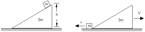

  • Two diagrams of a frictionless wedge of mass 3m on a horizontal floor: left, box of mass m at the top with height h marked; right, box moving left with speed v and wedge moving right with speed V.

As the block slides down, wedge moves towards right. When the box slides on the horizontal floor with velocity v, the wedge moves with velocity V towards right. Since no external force is acting on the system, according to the conservation of linear momentum, we have
MV = mv...(1)
According to conservation of energy
mgh = 1/2*MV^2 + 1/2mvf^2...(2) where vf is the final velocity of the box when it reaches the bottom of the wedge.From the eq.1 we can write
1/2MV^2 = 1/2*(mv)^2/M...(3) Substitute this in eq.2. We get
mgh = 1/2*(mv)^2/M + 1/2*mvf^2. Now solve for v.
relation between v and vf is given as
v = vf*cosθ - V.
