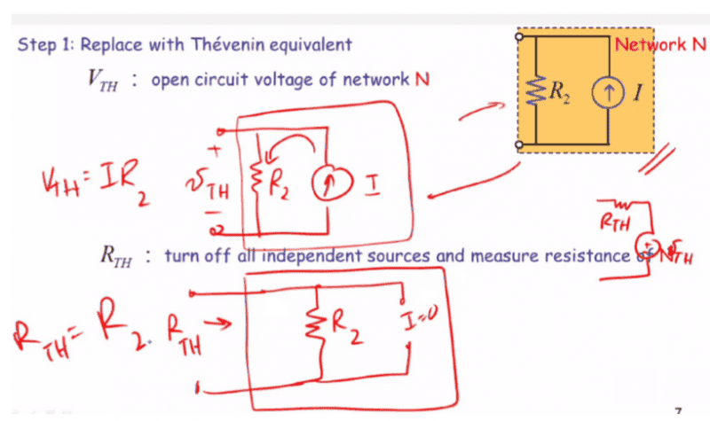

I created the above problem by modifying this problem on mitx:
http://i.imgur.com/PE0eSLC.png <--(I don't care about the solution for this, I care about the solution for the question I wrote above)
Quesiton A - What current is this? THe one going through R2
Question B- is V_th = capital i * R2?
The last question, Question C is "does R3 contribute anything now?"
I created this problem though it is loosely based on the original problem on mitx's website except I have added one resistor at R3

  • Handwritten annotations on a lecture slide titled Step 1: Replace with Thévenin equivalent, showing V_TH as open-circuit voltage of network N, V_TH = IR2, and R_TH = R2 with the current source turned off.
  • Handwritten annotations on a lecture slide titled Step 1: Replace with Thévenin equivalent, showing a network with resistor R2 and current source I, with V_TH = IR_2 and R_TH = R_2 found by turning off the current source.

With regard to your question, the added resistor does not effect the circuit at all. A branch with a current source will pump out the same current regardless of what the current source is in series with. And an open circuit (the hanging resistor) does nothing if no current can flow through it.
V_TH=R2?
and VTH=R2?
Somehow that does not sit well in my mind. What is R3 was ten billion ohms? Shouldn't that do something?

I'm not sure what you mean here. A resistance is not a voltage.
But with or without your new resistor, the circuits will behave identically (from the point of view of the load) and will have the same Thevenin or Norton equivalents.
Well, it'll generate a LOT of heat with the current that flows through it.
Remember, an ideal current source will produce ANY voltage required to maintain its specified current. So no matter how much voltage is dropped across a resistor that's in series with it, you'll still get the same current coming out of the combination.
