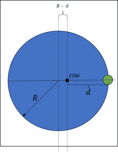

I'm confused about this, shouldn't it be:
$$ I_{cm} = \frac{2}{5}MR^2 + M(R-d)^2 + md^2$$

When you (we) did it the first time the fact that the center of mass of the system was shifted from the center of mass of the large asteroid (sphere) was not accounted for. We assumed the center of mass of the system was coincident with the center of mass of the sphere. Now accounting for that like @kuruman suggests I'm completely on board with.
But now that the center of mass is shifted, its like the diagram I posted in #62. But @kuruman doesn't agree with my computation of ##I_{cm}## as far as I can tell.

  • #77
erobz said:
All I know is the expressions for ##I_{cm}## in post #55 and #62 aren't equivalent. Do you concour that they aren't the same or am I missing something?
I did not explain myself well. This question was not referring to the calculation of the center of mass, but to ask if you would agree with me to wait for @kuruman's answer.
  • #78
Chestermiller said:
As an engineer, what approximations would you make in solving this problem?
With all due respect, I don't think this is an engineering problem. The problem statement says the mass ##m## is much smaller than mass ##M##, (I'll agree that is a confusing statement) but it doesn't say explicitly that mass ##m## is negligible w.r.t. mass ##M##, like it does the radius.
  • #79
Yes you are confused. The parallel axis theorem says $$I_{\text{parallel axis}}=I_{\text{cm}}+Md^2$$ where ##~M~## is the mass of the object and ##d## is the separation between the parallel axes.
Here
  • The mass of the object is ##M+m##.
  • The two parallel axes are the one going through the CM and the one going through the center of the planet O.
  • The distance between them is ##R-d##.
So in the parallel axis equation substitute
## I_{\text{parallel axis}}\rightarrow I_O=\frac{2}{5}MR^2+mR^2##
##Md^2\rightarrow (M+m)(R-d)^2.##
What do you get?

Oops, I forgot to capitalize. I corrected the typo. The moment of inertia of the just the asteroid about the center of the planet is ##mR^2.## Thanks for pointing it out and sorry about the confusion.
  • #82
No problem, don't worry. Therefore, the force ##F## is equal to ##F= m \omega ^2 d##, right?
  • #83
Right.

@kuruman We are looking top down, the axis of rotation is into the page, through the combined systems center of mass I have labeled ##com## is that true?
  • #87
Yes.

Then for just the sphere alone about the axis of rotation that is into the page labeled "com""
I get using parallel axis thereom:
$$ \overbrace{I_{com - axis }}^{\text{sphere}} = 2/5 MR^2 + M(R-d)^2 $$
You are saying that is incorrect for the sphere alone that is rotating about the combined center of mass axis labled "com"?
Because for the point mass we have that:
$$ \overbrace{I_{com - axis }}^{\text{point mass}} = \cancel{I_{cm}}^0 + md^2 $$
Do we not?
Then we combine them:
$$ \overbrace{I_{com - axis }}^{\text{combined}} = \overbrace{I_{com - axis }}^{\text{sphere}}+ \overbrace{I_{com - axis }}^{\text{point mass}} = 2/5 MR^2 + M(R-d)^2+ md^2 $$
