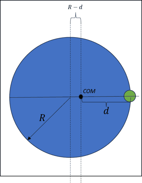

erobz said:
Think of them as two separate masses still. Do they both have center of mass velocity = ##v' + R \omega ##?
How do you mean? Imposing conservation of momentum in an inelastic collision, isn't the velocity of the center of mass the same for both bodies? I guess I don't understand...

I cannot confirm this answer. This is how to do it.
Angular momentum is conserved about the CM of the composite mass.
The distance from the center of mass to the embedded asteroid is ##d=\dfrac{M}{M+m}R.##
The angular momentum about the CM before the collision is the orbital angular momentum of the asteroid only. We are told that the planet is not spinning.
##L_{\text{before}}=mvd=\dfrac{mMv}{M+m}R.##
The angular momentum about the CM after the collision is
##L_{\text{after}}=I_{cm}~\omega.##
What expression did you get for ##I_{cm}##? I couldn't find it, but maybe it is implied somewhere. If you don't have it, use the parallel axes theorem ##I_O=I_{cm}+(M+m)(R-d)^2## where ##I_O=(\frac{2}{5}MR^2+mR^2)## is the moment of inertia about the center of the planet and ##(R-d)## is the distance between the parallel axes.
Then solve the momentum conservation equation for ##\omega##.

Thank you. I knew something was wrong with my process. The reasoning and the unfolding are similar to yours, what changes is the algebra. I am sure your procedure is more correct than mine. After solving the momentum conservation equation for ##/omega##, can I calculate the force ##F## as I did in post #1, that is, by ##F = m \omega ^2 R##? How would this force be directed? I am waiting for confirmation, thanks again.
Postscript. Since I did not understand some steps, could you draw a graphic diagram of the physical situation that would help me understand it better? How would the conservation of linear momentum discussed with @erobz change, considering your corrections and observations? Thank you.
  • #57
My guess would be the term “ ##\omega R## “ gets replaced with “##\omega d##”. How about you?
  • #58
I also think it may be so. Let's see if there is any other opinion disagreeing with this....
  • #59
That should go for the force ##F## too (replace ##R## with ##d##)
