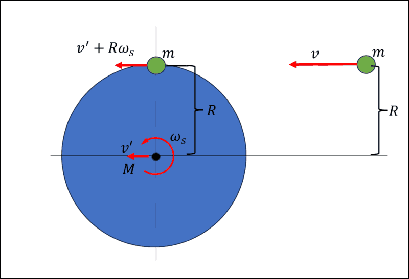

Okay, but how to make my equation for force per unit mass visibly proportional to ##\frac{m}{M}##? In the case where ## m \ll M##, how would such an equation become?
Not sure what you are asking. You have established ##\omega\approx\frac{5mv}{2MR}## and ##F\approx mR\omega^2##. Put those together.

Thank you, I understand now. So, the force ##F## is not approximate to ##0## when ## m \ll m## as was said previously, right?
Okay, so what we have is the full calculation giving:
$$F = \frac{25mv^2}{4R}\bigg [\frac 1 {1 +\mu} \bigg ] \bigg [\frac{\mu}{1 + \frac{7\mu}{2}} \bigg ]^2 \approx \frac{25mv^2}{4R}\big [\mu^2 -8\mu^3 \big ]$$Where ##\mu = \frac m M##
Whereas, if we make the simplifications earlier in the calculation, we get:
$$F \approx \frac{25mv^2}{4R}\big [\mu^2 \big ]$$These are the same up to the second order in ##\mu##. But, there is a factor of ##8## in the third order term.
With ##\mu = 0.01## there is still an 8% difference. That seems quite significant. You need ##\mu = 0.001## for the early simplifications to give only a 1% error.
I'm not sure what conclusion to draw.
Actually, my conclusion is that the question should be explicit about giving an answer to the first significant order of ##\frac m M##. Also, it seems pointless to calculate the centripetal force on ##m##. Calculating ##\omega## would make much more sense.

But, not really a mistake. I unwittingly made the simplification ##d \approx R##. Which is significant if we take ##\mu = 0.1##, which is too large for the simplifications to be valid.

Funny thing, I did too. My corrected exact value for ##\omega## when ##M=9m## is $$\omega =\frac{1}{5}\frac{v}{R}.$$It turns out that no approximation is needed if one uses the simplified moment of inertia in post#128.

It's not an assumption. I am following @PeroK's lead in post#95. I derived an expression for ##\omega## that I think is correct, I plugged in ##M=9m## and simplified. This allows for other users to check their answers against mine without anyone giving the answer away which is against our rules.

We have a series of calculations, all of which can be approximated at each stage:
$$d = \frac{MR}{m+M} = \frac{R}{\mu+1} \approx R$$$$I = \frac{MR^2}{m+M}\bigg [\frac{7m+2M}{5} \bigg] = \frac 2 5 MR^2\bigg [\frac{\frac 7 2 \mu + 1}{\mu + 1} \bigg ] \approx \frac 2 5 MR^2$$$$L = \frac{mvR}{\mu + 1} \approx mvR$$$$w = \frac L I = \frac{5mv}{2MR}\bigg [\frac 1 {\frac 7 2 \mu + 1} \bigg ] \approx \frac{5mv}{2MR}$$$$F = m\omega^2 d =\frac{25mv^2}{4R}\bigg [\frac 1 {1 +\mu} \bigg ] \bigg [\frac{\mu}{1 + \frac{7\mu}{2}} \bigg ]^2 \approx \frac{25mv^2}{4R}\big [\mu^2 \big ]$$The approximations are only really valid where ##\mu \equiv \frac m M \le 0.01##.
Edit: The approximations are only really valid where ##\mu \equiv \frac m M \le 0.001##.

You found an expression for ##\omega## in post #101.
Hak said:
Following the procedure described by @kuruman in post #55, I find that ##\omega = \frac{5mv}{(2M + 7m) R}##
What do you get when you substitute ##M=9m##? :rolleyes:

Is ##mv = M v' + m (v'+ \omega R)## correct? All this is irrelevant for calculating the force ##F##, right?
I have a doubt. In post #50, I calculated the linear momentum equation, which @erobz found to be correct in post #51.
Nevertheless, however, if we calculate the angular momentum with respect to the center of the asteroid of mass ##M##, we have that:
$$L_{before} = mvR$$
$$L_{after} = L_{cm} + y_{cm} V_{cm} (m+M)$$, where:
$$L_{cm} = I_{cm} \ \omega$$,
$$y_{cm} = \frac{m}{M+m}R$$ , obtained by placing an axis of reference ##Oxy## centered in the center of the large sphere,
$$V_{cm} = \frac{m}{M+m}v$$, obtained from equation ##(1) \ mv = (m+M) V_{cm}##.
Equalizing ##L_{before}## and ##L_{after}##, we obtain ##mvd = I_{cm} \omega##, the same equation calculated by @kuruman in post #55.
So, why is there discordance between the equation in post #50 and the equation (1) I reported in this post?

The theory we were laboring under there was updated 5 posts later. Have you properly updated the linear momentum equation?
