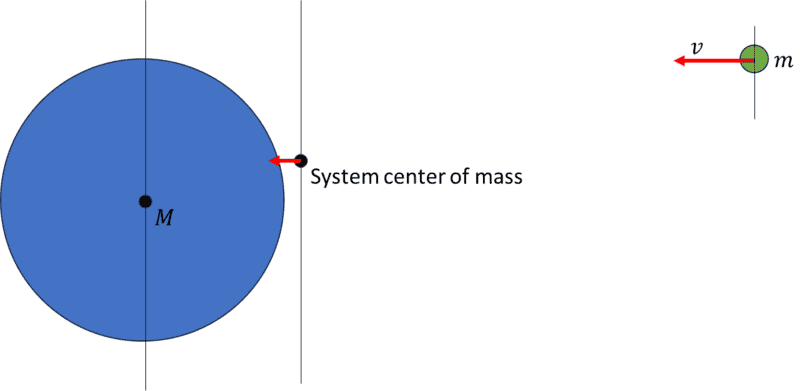

In Kleppner and Kolenkow, instead of algebriac answers, they would say (in this case), if ##M = 9m##, then
$$F = \frac{4mv^2}{81R}$$That's what I get.
If we take ##m \ll M##, then ##F = 0##.
PS I did make a mistake and authomatically used ##R## instead of ##d## when calculating ##\omega##.

My understanding of the problem statement is that you are supposed to assume that $$\frac{m}{M}<<1$$
Then ##F \approx 0##.
Chestermiller said:
and$$\frac{r}{R}<<1$$
Yes.
Hak said:
We get ##\omega' = \frac{(mRv)}{[(\frac{2}{5} + \frac{m}{M})MR^2]} = \frac{(5v)}{[2R(\frac{5}{2} + \frac{m}{M})]}##.
Shouldn’t that be ## = \frac{(5v)}{[2R(\frac{5}{2} + \frac{M}{m})]}##?
Reading through the thread, it seems some approaches are failing to make full use of ##m<<M##. That allows us to gloss over the difference between the resulting CM and the larger planet's centre, and to simplify the above to ## \frac{(5v)}{[2R(\frac{M}{m})]}=\frac{5mv}{2MR}##.

Following the procedure described by @kuruman in post #55, I find that ##\omega = \frac{5mv}{(2M + 7m) R}##. Substituting in ##F = m \omega ^2 d##, we have:
$$F = \frac{25 m^3 M v^2}{(2M + 7m)^2 (M+m) R}$$.
Therefore, for ##M = 9m##, I get:
$$F = \frac{9mv^2}{250 R}$$.
Where do I go wrong?

m<<M means we are looking for the smallest order nonzero approximation for small m/M. If a function of ##x## is ##\Sigma_{n=0}c_nx^n## that is ##c_ix^i##, where ##c_i\neq 0## and ##c_j=0## for ##j<i##.
So no, we cannot end up with F=0.

When I don't use ##m \ll M ## and plug in ##M= 9m## I get:
$$ I_{com} = \frac{9}{2}m R^2 $$
$$ \omega = \frac{v}{5R} $$
