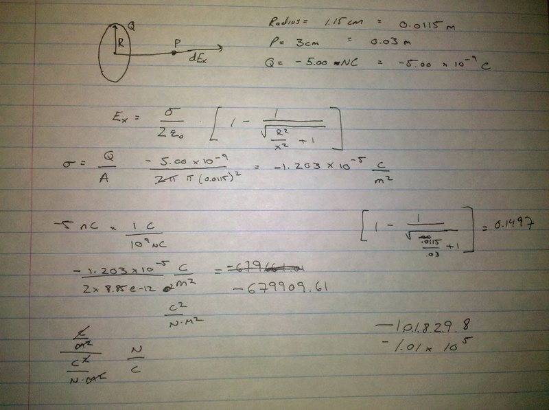

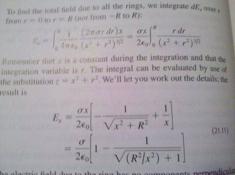

A charge of -5.00 nC is spread uniformly over the surface of one face of a nonconducting disk of radius 1.15 cm. Find the magnitude of the electric field this disk produces at a point P on the axis of the disk a distance of 3.00 cm from its center.
Surface area element for a disk [sigma]= Q / A
See attachments
So I plugged the numbers in accordingly, had no luck.
I appreciate the help.
  • Printed textbook page deriving the electric field on the axis of a uniformly charged disk by integrating over rings, ending with equation 21.11: Ex = (sigma/2 epsilon0)[1 - 1/sqrt((R^2/x^2) + 1)].
  • Textbook sketch of a uniformly charged disk of radius R with a thin ring of radius r and width dr shaded as dQ, on the axis with point P at distance x and the field component dEx pointing along the axis; above it, the formula dEx = (1/4πε0)(dQ/r²) = (1/4πε0)(2πσr dr)x/(x² + r²)^(3/2).
That equation only applies for infinitely large plates. This disk is not infinitely large.
Try using E=kq/r^2 to get the electric field due to the charge on one infinitely thin ring surrounding the center of the disk. Then, integrate over the disk.
