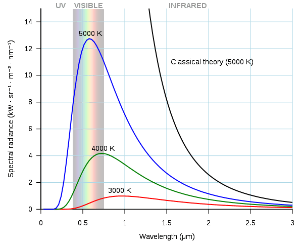

Check the wiki page on Planck's Law
There isn't a specific frequency (or wavelength) associated with blackbody radiation at a given temperature, rather there is a distribution of frequencies. The Wiki shows plots at various temperatures (3000, 4000, 5000 K). You can see, the peak of these curves moves towards longer wavelengths as the temperature decreases.

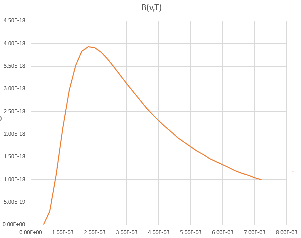

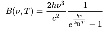

If I plotted the Planck's Law equation correctly, at 2.75K the peak is around 1.8*10-3 meter (right in the microwave band). The corresponding frequency (=c/wavelength) is ~170 Gigahertz.
So I think when they say "2.75K" and provide a frequency, they're talking about the frequency at the peak. If that's not right, maybe someone more knowledgeable will chime in and correct me.

The graph of the black body spectrum has a specific shape that is independent of temperature. If you make the temperature higher, the graph is scaled to higher frequencies. If you make the temperature lower, the graph is scaled to lower frequencies.
Here is the wiki link.
