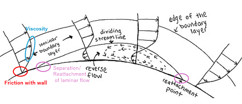

Imagine lumps of clay is running through pipe instead of liquid water. clay surface sticks on the pipe wall (friction) clay lumps defrm ( viscosity ) dragged from stick surface part and pushed force (pressure difference). Thus clay limps could go through the pipe any way. Though clay is more sticky and viscous than water, the same things take place.
Flow separation of boudary layer separation would be a topic of your interest. https://en.wikipedia.org/wiki/Flow_separation
I draw my comments on the figure in Wiki.
The clay that is going to flow in the end is the clay that had not stick to the wall, hence friction is between this moving clay and the other caly that had been stuck to the wall surface of the pipe
