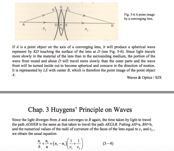

Okay, it is not an assignment question. I am just looking for an explanation regarding something I read. Why is the diagonal distance travel time(^-1) equal to [tex](n_2 - n_1){(\frac{1}{c_1} + \frac{1}{c_2})}[/tex] ?
Google http://www.tutorvista.com/content/physics/physics-iv/optics/lens-makers-formula.php (derivation)
Did you try to equate the two paths? If so, where did you get stuck?
