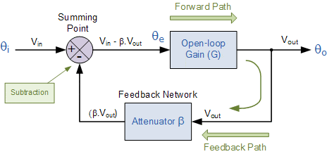

Hello, I have two questions about feedback.
1.

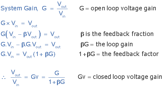

If we look at the equation above, it says
G(Vin-BVout)=Vout
but this equation is actually,G(Vin-BVout1)=Vout2
whereas Vout1 is Vout for first iteration and Vout2 is Vout for 2nd iteration.
Therefore, they must have different values.
How can we get the transfer function then?
2.
if we assume the very first iteration of the loop, V- will be greater than V+ as Vout>>>>>>>Vin.
At this point, V+-V- <0, therefore, it will generate a negative feedback opamp response.
and the next iteration vice versa.
How can we prove that if we proceed this iteration over and over, we will get the resultR2/(R1+R2)
kidsasd987 said:
G(Vin-BVout1)=Vout2
Why do you mention "iterations"?
An analog system does not "iterate" the output voltage.
Vout/Vin = G / ( 1 + Gβ ) is the correct expression. ( Mason's rule ).
An iteration would imply a time-delay. There is no such time-delay in your upper figure.
If there is a time-delay e.g. in the feedback, you must analyze a system, with the delay built in.

I'd like to add;
Q1. Your use of Vout1 and Vout2 would imply there was more than 1 output, where in this circuit there is only 1 output.
What you have attempted to label as Vout1 would always resolve to an open loop gain, as B would be 0 for that jiffy or 2.
Q2. You conclusion relies on your faulty conclusion for Q1. As the feedback loop is only connected to 1 of the +/- inputs, the gain shift will always be in the same direction.
