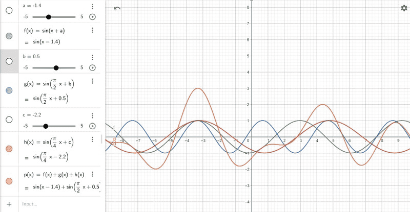

Averagesupernova said:
I don't know what your orange line represents and I'm not going to bother trying to find out. This is your project and if you are unable to conclude what you are looking at then you have no chance of designing circuits to create guitar effects. I assume based on your first post that this is what you want to do.
What I tried to represent with my orange signal/line is that the signals add up like in the links I've provided :

sophiecentaur said:
Absolutely But what "adds up" is the instantaneous volts (amplitudes) of each waveform. It's a linear system. At times, the voltages add in phase, which can give you a resultant value of up to 2v which corresponds to four times the instantaneous Power. But the mean power is just twice the Power.
Addition of Powers and Voltages is a constant source of confusion if we don't go back to basics.
Yea instantaneous adds up so the final result is like here :
Well I guess something like that. The mean can be indeed the 2x and not 4x the power. But I don't know if this is the answer though. I don't know if this information resolves my questions about the what pickup will do with this orange final signal (orange signal is the sum of all 4 signals here).
The pickup is what actually is summing the other signals to get the orange one.
But the input must be also a sine wave / waves am I wrong ? The pickup pick the vibration and the vibration itself must be sinus wave/waves. So I though from the link and they said that the sound/vibrations are these sinuses and they add up resulting in the single wiggly signal, which the orange signal was supposed to represent.
Hence the orange signal was supposed to be the vibration signal received by the pickup. So the output that is processed by the pickup with the sinus waves signals he produces the voltage equivalent. But still the input must be sinus waves or am I wrong ? If so is there any info about it somewhere ?
You get it what I try to say here ? Like vibrations are also sinus waves if so I just made one with orange signal that has it's peaks without units because no one mentioned in the website about it.
But still interesting intel to get. But still want to confront what I read/understand/drawn with how other says, from websites as well. Because I guess my understanding isn't that incorrect but still doesn't make sense with the output max voltage value to the input values represented by my actual understanding which is the orange signal/function representing the sum of couple of the string vibrations.

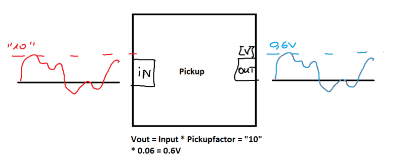

  • #52
PS
If pickup output can be max 1V and the input vibration signal it's peak can be "3", "10" etc. Then pick up must reduce it into 1V so hard clipping resulting in distortion. Which doesn't make sense because randomly playing will give distortion.
So how the Input looks like ? What is the unit of those input peaks because websites only shows the graphs with high peaks. Check them out. I am just recreating a simple example to them. So pickup receives these "4","10" etc peaks.
Lastly, the table it shows how big are the amplitudes for specific Playstyle ? Dunno. But it shows that strings can have 0.3 or even 0.8V while pickup can have max 1V so what if I add all 6 strings ? It must exceed 1 V because different frequencies peaks must all add up at some point

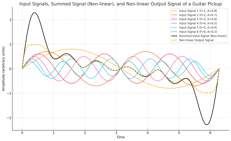

But here I was talking about pick up and not what op amp amplifies. Op amp amplifies what he gets from the pickup.
The website showed the sound amplitude which you've said yourself amplitude of 0.8V is a lot and if all 6 strings or more had 0.8V then peak can be even 4 V on the pickup itself although the pickup cannot exceed 1.4V as you mentioned.
I've used a bit of chatgpt he showed me some ideas and had some sense. Like if the vibration amplitude exceed the peak value "1" then the overall amplitude is reduced by the pickup.
It said that :
  • Generating Input Signals: Each string generates a signal with a specific amplitude and frequency.
  • Summing the Signals: These signals are summed, which can lead to very high amplitude values at certain moments.
  • Clipping the Signal by the Pickup: The pickup applies a nonlinear function, such as tanh⁡\tanhtanh, to limit the summed signal to a maximum value, e.g., 1V.
  • Nonlinear Summation of Input Signals: The pickup processes input signals nonlinearly, preventing simple linear addition of amplitudes.
  • Signal Clipping: The pickup uses a soft clipping function (tanh⁡\tanhtanh) to avoid distortion and provide a stable output signal.
So yea, but this nonlinear part is the black line, although it is just linear sum of all signals and reduced to be max 1V, maybe it has some sense.
But someone mentioned that pickup doesn't reduce the input signals so I don't know now how the pickup works with high peaks. Also chatgpt told me that these vibrations are :

Xenon02 said:
But I still wonder how pickup works when the sum of all amplitudes from sound or vibration exceeds this value "1". Like the sum of all signals is "100" and what pickup will do with this peak.
There is nothing in a normal pickup that will 'run out of range' so your "100" is an arbitrary number of mV. It's amplifiers that will limit the total excursion of the signal. Somewhere in the amplifier chain there will be an adjustable attenuator to take care of this.
Microphones can run out of headroom and you can get limiting with excess sound level. You can get rugged mikes for use with drums etc.

Do you have any information from websites/videos etc about it that pickup doesn't run out of range ? How input signal looks like and how to interpret the peak value of that input signal ? Does the value of peak equal to mV ? Because the input signal doesn't have unit or so I couldn't find on websites whole Output signal is in V or mV. Any source ???
If this diagram is incorrect.
Then what does the real diagram of input signal and output signal.
Like I said I couldn't find any example of vibrations signal which unit I don't know and the equivelant pickup signal on mV
Chatgpt is an idiot. It has collected garbage for you from the web.
You need a better crap detector.
The pickup is linear, it does not limit the output.
The amplifier is non-linear, it does limit the signal at its input.
