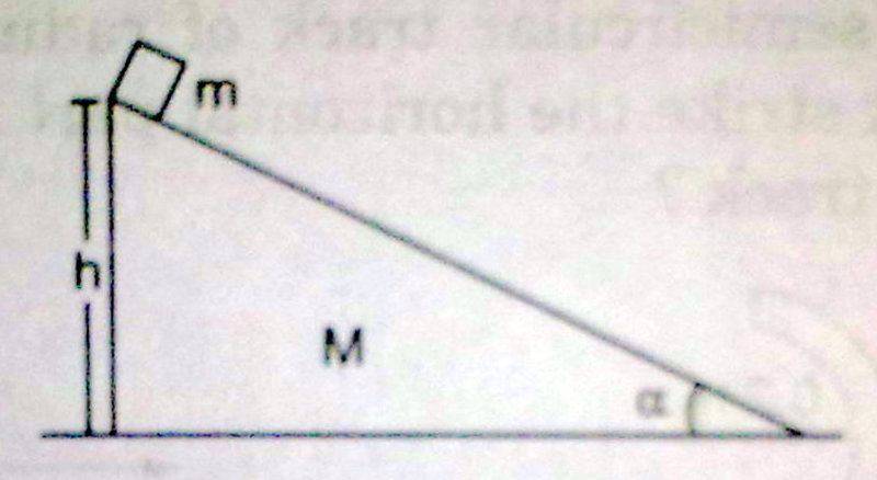

Look at the pic
Diagram of a small block m on the top corner of a larger wedge M with angle alpha at its base, a vertical height h marked on the left, and the wedge resting on a horizontal surface.
Obviously the smaller block will slide down and the bigger block will accelerate to right ... i want to know that what will be the acceleration of the bigger block ... i have found the answer using that Center of mass has no acceleration. but i want to find out using tradition way ... like F = Ma
What will be the force pushing bigger block towards right?
  • Diagram of a small block of mass m on the top corner of a larger wedge of mass M resting on a frictionless floor, with the slope angle marked as alpha and height h shown on the vertical side.
The block and wedge exert a normal force on each other. That's the force that pushes the wedge. (Looking at your diagram, I'd say that the wedge will move to the left, not the right.)
the block exert force of mg(cosα) at the bigger block
so the force in the right direction is mg(cosα)(sinα)
so acceleration is a = mg(cosα)(sinα) / M
but that is wrong
That would be the normal force if the wedge were stationary, but it's not. It accelerates.
but that is wrong
That would be true if the block is not accelerating in direction perpendicular to surface of wedge but that is not so because the wedge itself accelerates.
I am not getting you guys ...
Am i missing something conceptual?
On what basis did you conclude that the normal force equals mg(cosα)?
The acceleration of block is along the incline as well as perpendicular to it. Consider this and work on the fbd again

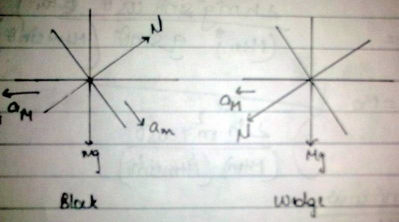

Here is my FBD:
Hand-drawn free-body diagrams of a block on a wedge: left diagram labelled Block shows mg downward, normal force N perpendicular to an inclined surface, and accelerations aM and am; right diagram labelled Wedge shows Mg downward, normal force N, and acceleration aM.
and as the cos component of weight gives N so its mgcosα
Is it wrong?
  • Two free-body diagrams side by side on lined paper. Left, labelled Block: a point with arrows for mg down, N up and to the right, and a_m down and to the right, plus a_M to the left. Right, labelled Wedge: a point with Mg down, N pointing down and to the left, and a_M to the left.
cupid.callin said:
Here is my FBD:
Is it wrong?
Your diagram for the wedge is OK (except that you left out the normal force of the floor on the wedge), but your conclusion that "the cos component of weight gives N" is not correct. N = mgcosα is true for a non-accelerating wedge, since the block would have no acceleration perpendicular to the plane thus the net force in that direction must be zero.
Just call the normal force N. Don't make any assumptions about what it equals.
Your diagram for the block shows the acceleration of the block as being parallel to the plane of the wedge. That's not exactly true, since the wedge accelerates.
Hint: The block is constrained to slide along the wedge. So, in the frame of the wedge, the block accelerates parallel to the surface of the wedge.
(This is a bit tricky, so take it slow.)
