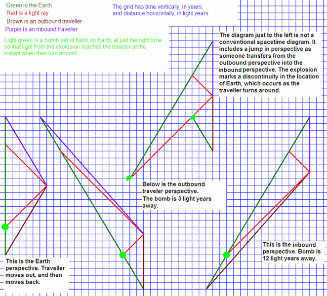

I have a problem with time dilation... You have all heard the story where there are two identical twins and one goes on the spaceship and flies around at nearly the speed of light, comes back, and is still young while everyone on Earth, including the twin who stayed there, are old. But... What if you were the twin on the spaceship? You would see the universe moving around you at near the speed of light and time passing slower for it, and you would think that you grew old while everyone else stayed young, aye?
If the twin on the Earth sees the twin on the spaceship as moving and himself as staying still then time dilation applies to the one on the spaceship and they would see the twin on the spaceship come back and say "Ooh, you look so young!" But if you were the twin on the space ship, the Earth and everything would be moving relative to you, time dilation would apply to the twin on the Earth instead of you, and you too would be like "Ooh, you look so young!" So depending on the frame of reference that you use for your calculations, a different person grows old... What am i not getting about this?
The twin that was on the spaceship turned around and came back so they accelerated - so special relativity doesn't apply.
Special relativity DOES apply. What does not apply is the simple case for a single frame of reference.
Special relativity is perfectly able to handle accelerated motions, as complex as you like. What special doesn't handle is gravity... and gravity is not involved here, only acceleration. In fact, general relativity is obtained by a kind of equivalence of gravity with the effects of acceleration that can be obtained using special relativity.

There are some other rather drastic differences. The frame for the twin on the ship is not a single inertial reference frame, but two different inertial frames at least (instantaneous turn around) or else it is an accelerating reference frame, in which strange things happen, like remote objects moving backwards in time.
But keep it simple. Image an instantaneous turn around, using some space warp of some kind that turns the ship through 180 degrees at a fixed instant.
The twin on the ship sees redshifted pulses on the way out, and blueshifted pulses on the way back. It sees these for equal amount of time.
The twin at home sees redshifted pulses for a much longer period... the time for the trip PLUS the time it takes light to get from the turn around point back to Earth.
Here's a diagram I have used in other threads, representing a trip at 60% light speed to star six light years distant. It takes 10 Earth-years for the trip, and 10 back again, during which time the ship experiences 16 years.
Note that there is a drastic discontinuity in the "frame" of the traveling twin, in which Earth is suddenly moved 9 light years away and 9 light years back in time. This is simply the result of a new perspective when they turn around. The angle subtended by Earth in the sky would also suddenly reduce by a factor of 4 when the remote twin turns around, because in the new perspective the light is coming from a point four times further away.
The twin at home sees no such discontinuity.

Yes. This is one of many ways in which the two ships are different., even from their own perspective.
Maybe that acceleration, even if instantaneous, somehow...
It's not the acceleration that matters, but the change of velocity. If you hard a warp drive that somehow reverses your direction without acceleration, it would still be the same. Imagine two space ships passing by one another, and Captain Kirk using a teleporter to jump from one to the other as they are passing. No acceleration; but a change in reference frame.

The ship that reverses direction sees the other ship suddenly become much smaller in the sky, as if the light is coming from much further away. That is because the the light IS coming from much further away, in the new frame of reference.
The ship that remains inertial sees no change in the angular size of the other remote ship when the other one reverses direction.
One shift, two shift, red shift, blue shift
If one ship moves away from the other at 60% light speed, moves for eight years by their own clock, then reverses direction and returns at 60% light speed, then they see the other ship redshifted for 8 years, and blue shifted for eight years. The factor of the shift is two. (Frequency is halved, then doubled).
The ship that remains inertial sees the other ship red shifted for 16 years, and then blue shifted for 4 years.

The thing is that inertial frames are special. They are the ones within which the laws of physics are what you are used to. There are a couple of ways you could define a co-ordinate system for accelerated observer, where they were always at location "0", but in such a frame you will find various things that never show up in an inertial frame, like like particles moving much faster that light, or light that moves as slowly as you like, or event horizons, or even time running backwards for remote particles. Such frames are not particularly useful.
Lorentz transformations can map co-ordinates in one inertial frame to those in another. You can correctly calculate the age of any twin, no matter how that twin accelerates, by finding their world line in any inertial frame and then integrating proper time u, using
[tex]du^2 = dt^2 - dx^2[/tex]​
You can, if you like, calculate the age of a twin piecewise, by picking a series of "events" for any given twin, and calculating the age change between events with different frames. The age change between events is the same no matter what frame you use, so this works too.
Cheers -- sylas
