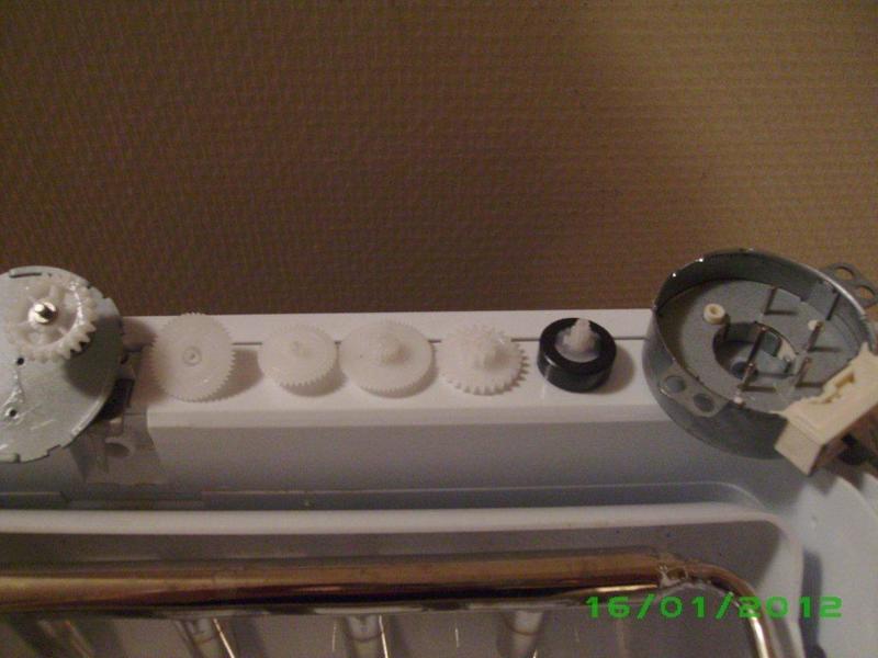

Could somebody to explain me, please, how works revers system on the one phase AC synchronous motor with two wires only. Model is 50TYZ-E and it is from small ice making machine. Where does this motor get information, that now is time to turn opposite way?

This motor turns a small plastic bath 90° one way and after ice cubics are ready - 90° opposite way. Small plastic bath - two ends. On the right side is motor, on the left side are two swiches (on the picture) with a distance 90°. To the motor comes two wires only, 230V AC. One wire is connected directly, second is connected through the relay. When I connect 230V AC directly to the motor, then sometimes it turnes CW, sometimes CCW - no rules.
The problem is, that this motor is connected to the plastic bath, which can turn 90° only, but it seems the motor has power enough to break the plastic connection with its axle. Yes, there are two swiches which should stop turning of motor, but I think the problem is not there. It can be, that already in the beginning of the refrigeration process the motor sometimes starts turning wrong way and breaks the plastic bath.
I found not much information from Internet about this. For example inside of this permanent magnet of rotator is a "switch" and if turning of rotator will be to heavy for motor, it starts turning opposite way. But there is a gearbox and I tried to stop it with nippers - no results, it turns anyway to the same direction and I even could not easily stop it.

  • Photo of two small gear reduction units from an AC synchronous motor, showing plastic gears and a motor housing mounted on a white surface.

something somewhere has to tell that motor which way to run.
could there be a mechaniical link inside the motor that we're not seeing?
that black piece looks like the rotor
and it looks like pole pieces down in the recess
lift that white plastic termination block and the flat plate, see if there's something to switch the windings or move a magnet... I'm suspecting a tiny magnetic memory switch of some sort that makes it reverse directions every time it's energized..

The direction of rotation depends from the position of rotor in the beginning of the activation. If I turn the rotor manually ca 45 degrees to the left or to the right from the neutral position, it starts rotation opposite way.

"""The direction of rotation depends from the position of rotor in the beginning of the activation. If I turn the rotor manually ca 45 degrees to the left or to the right from the neutral position, it starts rotation opposite way. ""
ahhh now you're homing in on it.
i believe you'll find a rotor with a permanent magnet poles on it, that's what makes it synchronous, and a reversing pawl .

but it's significant that a single phase motor is happy to run either direction - you just got to get it started.
here's the relevant text from that link
When the power is first applied, the rotor typically just jiggles around for a short time, until a N on the rotor aligns perfectly with a S on the stator. As the poles alternate between N and S magnetic polarity, the rotor follows the field and turns, jumping from one pole to the next to maintain attracting magnetic polarities. It may choose to run in either direction at this time.
By adding a direction-sensitive pawl,
the motor is usually set up to ensure the pawl engages with the rotor should the motor spin in the wrong direction. This stops the rotor, but adds sufficient "bounce" to force the motor to run the right way. The lug on the rotor can be seen in Figure 4 - the pawl is attached to the first "wheel", driven by the rotor pinion. A simple viscous (oil) drive pushes the pawl into the rotor should it spin in the wrong direction. Correct rotation keeps the pawl against the right hand red post and out of the way.
i don't know what's inside it but expect you'll find a two pawl arrangement to make it swap direction on every start. that's my best guess.
