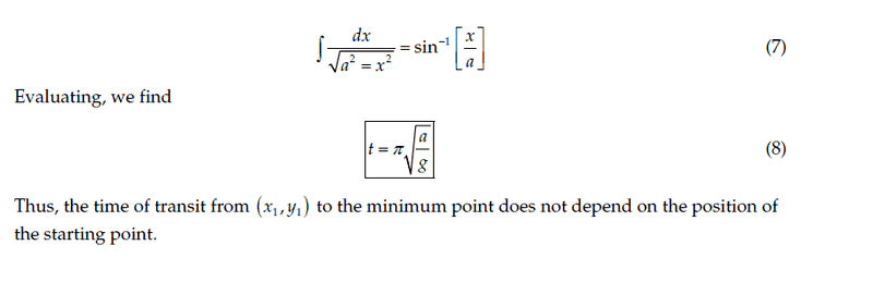

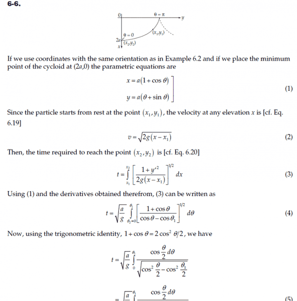

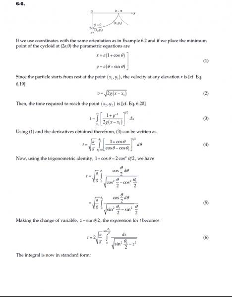

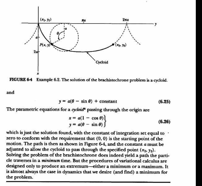

This is the solution of Brachistochrone .
I am very confused that how the x in equation(6.24) get its value a(1-cosӨ) ? What is the technique behind this solution of x?

It is just a clever substitution that replaces x. How to find that:
- in theory: "oh, it is completely obvious that this substitution will lead to a nice solution!"
- in practice: "let's try several approaches until one of them works"
Why only a(1-cosӨ ? What is the theory behind this substitution?
There is no deeper theory. It is a clever definition of Ө. You can see that it works nicely later.
You could also choose x=Ө2 + 3 cos(Ө) but that wouldn't help.
To motivate the substitution (6.24), first make the substitution x = au in (6.23). Then complete the square in the denominator. From your experience with integration, you should then see what might be another good substitution to further simplify the integral.
