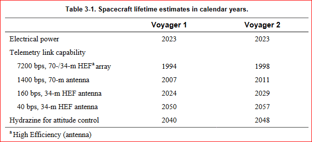

I recall the Voyager modulation was biphase (BPSK) which was coincidental to the same modulation that I was using at the same time. The bit rate significantly affects distance as the SNR is improved by matching the BW of the receiver to the spectrum of the signal. This is called the Matched Receiver condition for Gaussian Noise.
Thus reducing the bit rate also extends the lifetime of the mission.
But I learned much more from reading this 2013 paper about the sources of noise from solar flares, and adjacent instruments. Such that Friis Law is not the only one for path loss, SNR and error rate and ( i expect) the next Carrington Effect is due shortly after the planned 2025 termination of the Voyageur Interstellar Missions (VIM). (unless some posts an update)
https://voyager.gsfc.nasa.gov/Library/DeepCommo_Chapter3--141029.pdf
They used all the encoding methods to optimize error rates with convolution and ECC which extends the error rates by at least 2 decades of bits between errors after error correction.
There are many modes of redundancy, so this article is intended for those with Telecom/Telemetry experience but achieved the greatest distance for a Telemetry signal much more complex than the original Morse code in order to track the Doppler shift with Earth's rotation, maintain solar power, and earth tracking while collecting an array of electromagnetic experiments.
https://voyager.jpl.nasa.gov/

"On the Lighter Side" Theory is when you know everything but nothing works. Practice is when everything works but no one knows why. Theory and practice are combined: nothing works and no one knows why.
TonyStewart said:
These are theoretical assumptions, not proven yet with many problems to solve.
Let's hope the estimated power failure year of 2023, in your table is a gross underestimate. Just as they were doing so well. . . . .
I think it is pretty accurate as they have already shut off some heaters and will shut down experiments to extend the life a bit more. They had LOS in July when a command sequence resulted in a shift of the antenna by 2 degrees but luckily were able to "Shout" a re-aim command sequence in August to re-acquire the signal. https://voyager.jpl.nasa.gov/news/details.php?article_id=130
