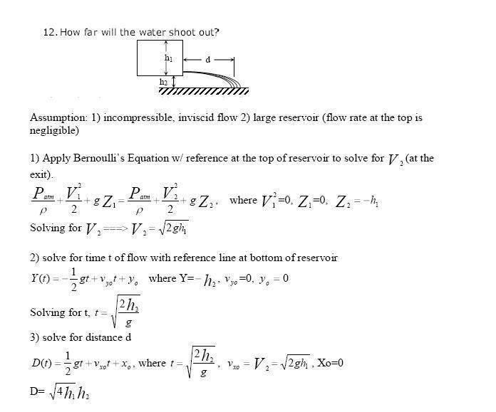

How far will the water shoot out?
  • Thread starter Thread starter ksle82
    Water
The discussion centers on calculating the distance water will shoot out based on the physics of projectile motion. A user shared an attachment titled "waterdistance.JPG" that visually represents their calculations. The formula referenced is the kinematic equation y = (1/2)gt², where g represents the acceleration due to gravity. The user requested feedback on their approach, indicating a need for clarity on the application of the formula.

looks good.
only a typo of latexat y= (1/2)gt^2...
