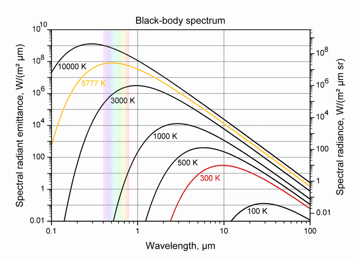

Bystander knows what a micrometer is: he was answering your (main) question. To answer the follow-up question, it is a function of black body radiation (equations on its wiki page), with the peak frequency corresponding to the temperature:

Actually, water vapor is fairly transparent to the ten micron wavelength band. That is why that band forms one of the humid atmosphere's IR "windows". On the other hand, liquid water absorbs it quite nicely. This band is one of the major sources of terrestrial IR for clouds, and the reason cloudy nighttime skies are "warmer" than clear ones. They produce "back" radiation to the Earth's surface that is absent under clear skies. This radiation, in turn, comes in large part from the warming caused by the absorption of the ten micron band. This band is the peak wavelength in the surface IR emissivity.
