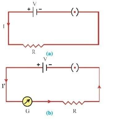

In (fig. a) we want to measure current passing through the resistance R in a circuit shown in fig.
I=V/R
In (fig. b) galvanometer is joined in series with resistance R, as shown in fig.
In such connection resistance G of the galvanometer is added in the circuit
and as the total resistance of the circuit is changed the value of current to be measured itself is changed
I = V/(R+G)
Thus the true value of current is not obtained.
this fact indicates that the resistance of current meter should be as small as possible.
So we can't use the low resistance wire that directly wound on coil so that you will get directly,
I = V/R.
