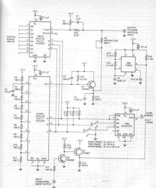

How are light bulbs turned on and off in sequence for some signs and flat screen televisions?
How are electromagnets turned on and off in sequence to accelerate maglev trains and coil gun bullets?
How are the CCD arrays in electronic cameras turned on and off in sequence to transmit the captured images to the recording device through a serially transmitted electrical signal?
For simple systems, a timer/clock pulse is generated (eg by an NE555 chip) then fed into a counter chip which will count up in binary (so for each pulse the counter will increment in binary - 0000, 0001, 0010, 0011, 0100 etc). Those binary states can then be combined via digital gates (AND/OR/NOT) to give output signals/states at specific time.
Fancier systems like washing machines use microcontrollers
In the olden days, it was reels with revolving contacts/bumps pressing microswitches.
Yes, usually the counter will be implemented as a jump counter so that the electrical output can automatically be switched from one output terminal on the IC chip to another output terminal but how is this accomplished electronically within the circuitry of the IC chip? What type of electrical phenomenon makes this possible?
There is a class of chip between microprocessor and just a bunch of gates called a multiplexer. A good example is the 8 line to 1 line 74151 IC.
These can operate at video frequencies and above.
These are electronic versions of the revolving contacts called actuators or contactors, which were actually pretty sophisticated and reliable so don't sneeze at them either. However mechanical systems are frequency limited to a few kHz at best.
Yes, how does the IC chip perform the function of the electromechanical contactor but in a solid state manner?
Depends on the application. In some cases the IC would drive electromechanical relays in other cases a transistor can be used to stick with a strictly solid state design.
Have you googled the spec sheet or multiplexer in general?
The following is a mid 70s circuit to put 8 channels on a single channel scope.
  • Schematic of an 8-channel digital signal multiplexer feeding a scope vertical input, using a 74LS151 multiplexer, CD4051 analog multiplexer, 7493 counter, 555 timer and transistor drivers.
