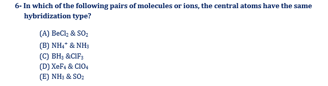

How could I know the hybridization type in such a question

Thanks all, that was so useful. obviously letter B is the right answer
Why not also E?
Is BeCl2 in the gas phase or solid?
Does neutral ClO4 really exist?
I wonder who poses these brain dead exercises?
DrDu said:
Why not also E?
In E. hybridization type is sp3 in NH3 & it is sp2 in SO2 so it is wrong
If BeCl2 is gas or solid, I don't think there would be a difference in the answer
ClO4, I think it is so hard for such a molecule to be found
You can argue that in SO2 S is also sp3 hybridized and that the somewhat larger bond angle is due to electrostatic repulslion of the oxygens. So you can equally well describe it with sp2 or sp3.
In the case of BeCl2, which is a solid at room temperature, Be is coordinated by 4 Cl atoms, so that a sp3 hybridization is also most natural.
