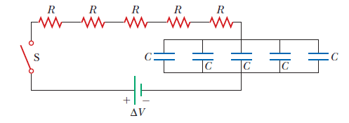

What is the time constant of the circuit shown in the figure? Each resistor has resistance R, and each capacitor has capacitance C. Internal resistance of the battery is negligible.
See the attached figure.
tau=RC
I assume that the R term has a coefficient of 5, due to the 5 resistors in series each with resistance R. I am confused about the capacitors. Since they are parallel, I assume that I can convert to the equivalent capacitor:
Ctotal=C1+C2+C3+C4+C5
resulting capacitance is 5C. So with terms of 5R and 5C, I get:
tau=25RC
am I on the right track?
  • Circuit diagram: a battery of emf ΔV with switch S in series with five resistors labeled R, followed by five capacitors labeled C connected in parallel between two wires.
Not only are you on the right track, you've reached your destination!
