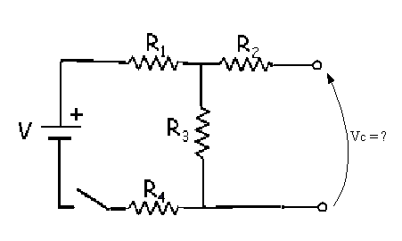

i tried using the usual Q=VC to answer this question for a multiloop RC circuit, "What is Q(∞), the charge on the capacitor after the switch has been closed for a very long time?" and my answer was wrong. clearly, i can't find Qmax because the resistors contribute to the voltage drop.
i can't seep to wrap my head around finding the proper equations for finding Q using kirchhoffs laws and end up having multiples unknowns. the image of the schematic is attached. any help? thnx.
kirchoff's loop rule and junction rules
I) I1=I2+I3
II) -I2R2+Q/C+I3R3=0
III) -I3R3-I4R4+V-I1R1=0
based on a previous question, i was able to find I4= V ((Req for R2andR3)+R4+R1)

Suppose you were to remove the capacitor from the circuit. What voltage would be presented at the terminals where it was connected?
removing the capacitor, it would be a regular combination circuit where V3=V2, R3 and R2 would have an equivalent Req= 1/((1/r2)+(1/r3)). but would the current be additive, or equivalent (based on kirchhoffs rule i1=i2+i3) ?
the potential would be same at both junctions.
By remove I mean cut it out of the circuit and leave its connection points open. Like this:
oh! then only one loop remains. that's what establishes one of the loop equations:
-i3r3-i4r4+v-i1r1=0.
here, we'd have known value for V and i4r4, but unknowns for i3 and i1

I intended the "void" as you call it, and as I drew it in the diagram that I provided in a post above. I'm looking for Vc as indicated.
So maybe in wrong here, but then there are no unknowns?All the R values for the resistors and the V from the battery are given, and current for R4 I found was based on this question,"The switch has been open for a long time when at time t = 0, the switch is closed. What is I4(0), the magnitude of the current through the resistor R4 just after the switch is closed?"
I'm lost now. What am I solving for?

I have no idea what things you solved for before, or what the component values might be since you haven't posted them in this thread.
I am approaching the problem that you stated in the first post of this thread: "What is Q(∞), the charge on the capacitor after the switch has been closed for a very long time?" So we are looking for Q(∞), right?
So as far as I know, we are dealing with the problem symbolically (without numerical values to plug in), and the switch has been closed for a long time so that the circuit has reached a steady state with the capacitor charged to its maximum amount. To accomplish this, it would be expedient to find the steady-state potential across the capacitor. That is why the potential across the output terminals that I drew is important; that voltage will be the same as that across the capacitor at steady state.
you're right. should i post the whole question with all the known values? it might be better approachable then

Okay, so I come back to the question, what is the voltage across the open terminals where the capacitor would sit?
using the equation we reached at before, -I(R3+R4+R1)= -V, i used the current for I4 from part 1 and multiplied it by the sum of the three resitors in the left loop and got 17.135 V ... :S which is greater than V(battery) !

What's your current value? Remember, this is steady state when there's no current through R2 and the capacitor. This will not be the same current as when the capacitor is first starting to charge up.
i guess i didnt pay attention before, but the I4 from part 1 (which was 0.06119 A) pertains to t=0 (thanks for pointing it out). so at present, i don't have a value for the current. would i find the sum of the resistors and divide it from the battery voltage? if so, v=0.042857143
Okay, so I = 42.86 mA .
What then is the potential drop across R3?
multiplied the current by each of the three resistors: R1= 1.328 V, R3=4.628 V, R4=6.042 V. so from here, would i be safe to presume that V3 is equivalent to the branch with R2 and the capacitor (reconnected)? I'm just trying to actively be a part of the solution :D, but i may be wrong.
Yes, the potential across R3 will be the potential presented at the open terminals where the capacitor will connect. It will thus be the steady-state potential across the capacitor...
oh finally! thankyou. but could you summarize the theory behind the process we went through? it could help clarify the big picture for me. thnx
The idea is that at steady state there will be no current flowing through the capacitor branch. This is the case when the potential across the capacitor is the same as that provided at its branch's connection points to the rest of the network. No potential difference means no current.
So, to find out what that potential difference is, remove the capacitor and determine the potential at the open terminals thus created.
