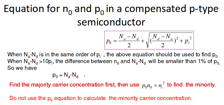

Equation in pink:
I was absent so I was going through the slides and I saw that equation. There isn't a derivation shown. Do you guys have any ideas?

What course is this?
What do the symbols mean?
This is for solid state physics.
n0 represents the number of electrons in a semiconductor. p0 represents the number of holes in a semi conductor.
NA represents the number of positive (acceptor) ions. ND represents the number of negative (donor) ions.
ni=pi=n0=p0 in an instrinsic semiconductor.
Maybe you could start with the density of states.
If you Google "carriers doped semiconductor", 7 out of the top 7 results will lead you to a derivation. I stopped counting at that point. :biggrin: http://ecee.colorado.edu/~bart/book/extrinsi.htm is the first.
