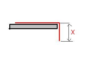

There is a chain of uniform density on a table with negligible friction. The length of the entire chain is 1 m. Initially, one-third of the chain is hanging over the edge of the table. How long will it take the chain (in seconds) to slide off the table?
I tried to use conservation of energy.
Initially position of CM of hanging part of chain wrt to table is 1/3.
And mass of part of chain hanging down the table is 2m/3.
So ##{ E }_{ pi }=\frac { 2mg }{ 9 } ##
If the chain falls by distance '##x##'
then position of CM of hanging part of chain wrt to table will be ##(3x+2)/6##
And mass of part of chain hanging down the table will be ##(3x+2)m/3##
So ##{ E }_{ px }=\frac { { (2+3x) }^{ 2 } }{ 18 } mg##
The potential energy is converted into kinetic energy.
So ##\frac { { (2+3x) }^{ 2 } }{ 18 } mg-\frac { 2mg }{ 9 } =\frac { 1 }{ 2 } \times \frac { (2+3x)m }{ 3 } { v }^{ 2 }##
on simplifying I got
or ##\frac { 1 }{ { v }^{ 2 } } =\frac { (3x+2) }{ x(3x+4)g } ##
or ##\int { dt } =\int { \sqrt { \frac { (3x+2) }{ x(3x+4)g } } dx } ##
Is this correct till here?

I would do this differently. Work out the problem generically, then plug in the details. For example. Let ##x## denote the vertical coordinate of the chain's free end. The potential energy of the chain is ##U(x)##. The mass of the moving part of the chain is ##m(x)##. Conservation of energy then gives $$U(x_0) - U(x) = {m(x) v^2 \over 2}.$$ Which yields $$ t = \int\limits_{x_0}^x dx \sqrt{m(x) \over 2\left[U(x_0) - U(x)\right]}.$$ Now express ##U(x)## and ##m(x)## correctly and you have the problem solved.
I agree, but I imagine that the whole chain moves, so m does not depend on x. KE=1/2 mv2. The potential energy depends on the hanging mass, which is mx/L. Initially L/3 is the hanging length.
ehild
As the chains free end is at distance ##x## so the CoM of chain will be at a distance ##\frac { x }{ 2 } ##.
As the mass is distributed uniformly so mass of chain is ##\frac { M }{ L } x##
So ##M(x)=\frac { M }{ L } x##
and ## U(x)=\frac { M{ x }^{ 2 } g}{ 2L } ##

Anyway, the length of the chain is constant and all its parts must reach the edge somehow. It can be said that the whole thing is piled up at the edge of the table and has zero volume but it is far from being physical. You are right, it must have been specified by the problem writer.
I used to give the same problem to my pupils, but the chain was a snake, and I added the picture.

If the chain is heaped up at the edge of the table initially, or if it is laid out straight, but you are going to ignore the horizontal velocity of the descending part, then you cannot use conservation of energy. (This problem is come up so many times on this forum, in different guises.). Use momentum.
If you want to take it as initially straight and incorporate the horizontal movement in descent, the problem becomes very difficult. You need to consider the shape of the descending arc in order to get the PE right. See 'chain fountain'.

Initially ##2/3## of chain is hanging from the table sa ##-\frac { m{ x }^{ 2 }g }{ 2 } ## becomes ##2mg/9##
also L(length of the chain is 1m).
Really? Then why does the problem say "one-third of the chain is hanging over the edge of the table"?
voko said:
Is this what you intended to say? Frankly, I do not see why (I assume the volume of the chain is negligible).
I saw this question online on a website.I think this is poorly stated problem.However ehild's explanation in #post6 sound good to me.
It should be ##\frac { mg }{ 18 } -\frac { m{ x }^{ 2 }g }{ 2 } =\frac { m{ v }^{ 2 } }{ 2 } ##
or ##\frac { mg-9m{ x }^{ 2 }g }{ 18 } =\frac { m{ v }^{ 2 } }{ 2 } ##
or ##t=\int _{ 1/3 }^{ 1 }{ \sqrt { \frac { 9 }{ g(1-9{ x }^{ 2 }) } } dx } ##
For the integral, substitute 3x=cosh(u)
ehild
Still incorrect. The left-hand side is always negative.
Yes there were sign mistakes
As ##{ K }_{ i }+{ U }_{ i }={ K }_{ f }+{ U }_{ f }##
so ##0-\frac { mg }{ 18 } =\frac { m{ v }^{ 2 } }{ 2 } +\frac { -m{ { x }^{ 2 } }g }{ 2 } ##
or ##\frac { m{ v }^{ 2 } }{ 2 } =\frac { m{ x }^{ 2 }g }{ 2 } -\frac { mg }{ 18 } ##
or ##\frac { m{ v }^{ 2 } }{ 2 } =\frac { 9{ mx }^{ 2 }g-mg }{ 18 } ##
or ##9{ v }^{ 2 }=(9{ x }^{ 2 }-1)g##
or ##\frac { dt }{ dx } =\sqrt { \frac { 9 }{ (9{ x }^{ 2 }-1)g } } ##
or ## dt=\sqrt { \frac { 9 }{ (9{ x }^{ 2 }-1)g } } dx##
or ##\int _{ 0 }^{ t }{ dt } =\int _{ \frac { 1 }{ 3 } }^{ 1 }{ \sqrt { \frac { 9 }{ (9{ x }^{ 2 }-1)g } } dx } ##
or ##t=\frac { 3 }{ \sqrt { g } } \int _{ \frac { 1 }{ 3 } }^{ 1 }{ \sqrt { \frac { 1 }{ (9{ x }^{ 2 }-1) } } } dx ##
or ## t=\frac { 3 }{ \sqrt { g } } \int _{ \frac { 1 }{ 3 } }^{ 1 }{ \sqrt { \frac { 1 }{ 9\left( { x }^{ 2 }-\frac { 1 }{ 9 } \right) } } } dx ##
or ##t=\frac { 1 }{ \sqrt { g } } \int _{ \frac { 1 }{ 3 } }^{ 1 }{ \sqrt { \frac { 1 }{ \left( { x }^{ 2 }-\frac { 1 }{ 9 } \right) } } dx } ##
or ##t=\frac { 1 }{ \sqrt { g } } \log { \left| x+\sqrt { { x }^{ 2 }-\frac { 1 }{ 9 } } \right| } ##
or ##t=\frac { 1 }{ \sqrt { g } } \log { \left| \frac { 3x+\sqrt { 9{ x }^{ 2 }-1 } }{ 3 } \right| } ##
where limits are - lower limit is ##1/3## and upper limit is ##1##
Is it right?

One should certainly not assume conservation of energy without some justification. If you think about how the process would operate in detail (for the bunched chain), you run into some interesting issues. Once the chain is moving, each link has to accelerate instantly from rest to a nonzero speed as it leaves the table. That sounds like a non-conservative impulse to me. If you try to make the process smoother, you see KE going into other modes, such vibrations (longitudinal or lateral) in the chain.
Much safer is to use conservation of momentum. And voila, you get a different answer.
For the case of the chain starting stretched out across the table, clearly some of the energy goes into horizontal motion, which persists as the chain descends.
