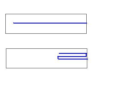

In problem the chain was lying straight on the table.Suppose if the chain was heaped on the table such that only the part of chain which is hanging from the table travels with velocity "v",then I think that I should not use equation in #post5 to find the time.(as haruspex suggested)
How can I use conservation of momentum here?
  • #44
Suppose there's length x hanging at time t. In time dt, what force acts to accelerate the system? What momentum does it impart? What is the change in momentum of the chain?
