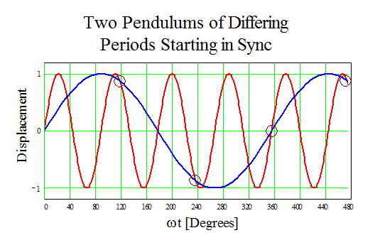

A graphical demonstration is offered showing that the pendulums sync up before four full cycles of the faster pendulum, confirming the book's result of n = 4/3 is likely correct.
One pendulum has a period of 2 seconds and the other 8 seconds using the pendulum period formula:
##T = 2 \pi \sqrt{\frac{L}{g}}##
So one has a frequency four times the other. If we plot displacement as a function of ωt for both then we have two sinewaves:
Line graph titled Two Pendulums of Differing Periods Starting in Sync, plotting displacement from -1 to 1 against ωt in degrees from 0 to 480. A red curve oscillates faster than a blue curve, and both start at 0. Small circles mark points where the two curves meet at the same displacement.
The circled points are places after time = 0 where the displacements are the same and the pendulums are moving in the same direction, i.e., they are momentarily in sync again. The first such occurrence is at ωt = 120°, and corresponds to 4/3 periods for the faster pendulum (red curve in the image).
A fairly simple algebraic solution is also possible which yields the solution exactly, but it is left as an exercise for the astute reader :smile:
