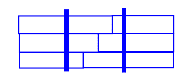

Sure, but I could have done the same two spikes with my staggered arrangement: #1 and #3 would have immobilized the ends, just like yours:
Diagram of a brick wall in staggered running bond, with vertical metal spikes passing through the courses and into the ground below, shown in cross-section.
Thing is: both your and my 2-spike implementation have the same flaw: the two sides are not stitched to each other - only to the ground. If you pushed inward on one side or the other, the stitch would still shear.EDIT: OK, I see you qualified it, recognizing that there is still some give in your joint, just not as much as in mine.

In my initial diagram, all ends are secure.

DaveC426913 said:
I see 3 as well. How do you get 4?
Yeah, but your upper and lower on the right can pivot around the spike. You'd need another spike over there to make it such that every beam has 2 spikes, so that it cannot pivot.
But they cannot pivot since they're secure at the other end.
Ah, well in that case two spikes should be fine as in your post #8. I had not realized that you needed them stitch to each other, thus my post #2. With that caveat, your post #10 shows a good solution except for the obvious extra work of making the lap joints.

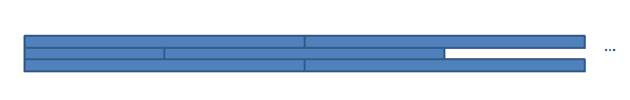

Why not over lap more? Cut one of the 6x6 in half, go from there.
244590
  • Diagram of three rows of blue rectangular bars: top row split into two bars, middle row split into three bars with a shorter gap on the right, bottom row split into two bars, all aligned to a common left and right edge.
