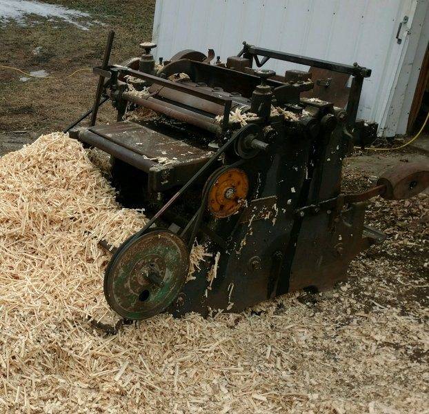

Planer blades are among the most difficult woodworking tools to keep in top shape and they really NEED to be in top shape to do their job properly.
To get a truly furniture quality board, it needs to be run through a drum sander after planning. You can ALWAYS expect a planer to leave strips.
Truth is most planers nowadays are junk. To get one to plane anything more than 4 inches wide is asking a lot. They are just not built solid enough. This is one that I use. Not kidding.
