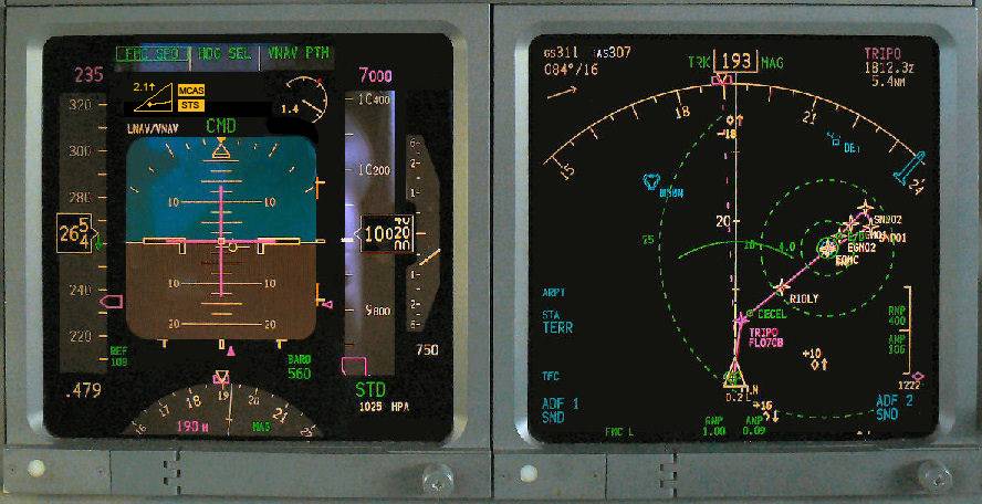

I made this for fun. It's a stab position display added to the Primary Flight Display. Not sure if that real estate is available but just made for fun as a proof of concept. It's to the left of the AoA display, above the attitude indicator on the left. Fairly self explanatory. It shows a graphic representation of the stab orientation. The number shows the stab trim angle and an arrow shows the position of up or down of the stab from leading edge. Two other annunciations show if MCAS is operating, same with STS. Perhaps the entire graphic could change to a red color if the stab is at a maximum down or up position.
Self explanatory seems to mean something different to you than to me. :-)
Cheers
It should be self explanatory to those following the thread. Let me know what's not clear and I can try to further explain.
