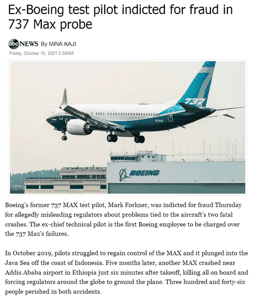

  • #637
Oops...
https://abc7news.com/ex-boeing-test-pilot-indicted-for-fraud-in-737-max-probe/11127038/
  • #638
Boeing itself is apparently "too big to charge" in that they would be precluded from a host of federal contracts if convicted.
Not that this guy isn't culpable as hell IMHO...
  • #639
Well it seems almost logical that he wasn't acting alone but more like "taking one for the team" so probably got paid to do so , otherwise why would he ?

  • #643
This guy crashed the plane in the simulator because of the difficulty of overcoming the actions of MCAS. He then forcefully petitions the FAA that the existence of the system need not be divulged to pilots. A bad idea, stupidly implemented and then hidden.
I guess the law does not recognize the term "reprehensible"
  • #644
According to the indictment, in late 2016, Forkner discovered information about an important change to MCAS and withheld it. In an instant-message chain between Forkner and then technical pilot Patrik Gustavsson, the chief pilot described a scenario in which he witnessed the MCAS “running rampant” during a November 2016 simulator session, some four months before the Max received its certification from the FAA.
What exactly does MCAS “running rampant” mean? Was the simulator session flying the normal flight envelope of the plane and simulating failures or were they doing acrobatics. Some context is needed.
