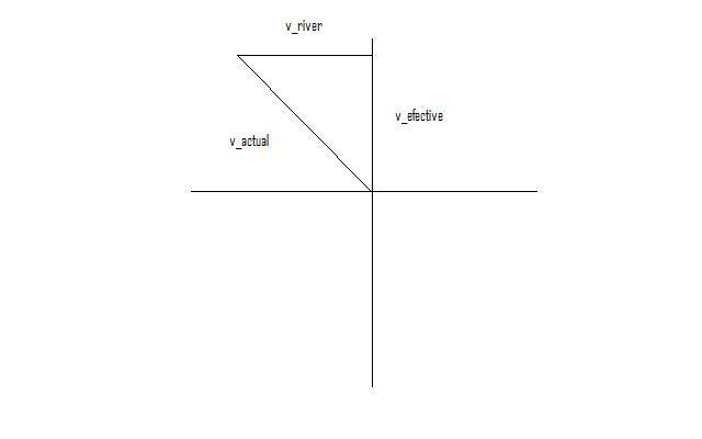

Vector diagram with x and y axes: v_river points horizontally to the left from the top, v_actual points down along the x axis, and v_effective runs diagonally from the top-left to the origin.
If the effective velocity is not at the right angle to the flow velocity, can the ferry serve towns directly opposite each other on a river?
It can't. v_effective is calculated on the premise of v_river being perpendicular to v_effective. If the position of the town is shifted, the angle between v_actual and v_effective will change and therefore the ratio between v_effective and v_river will change
The goal of the ferry is to connect the towns. So its effective velocity must be directed "across the river", which means it must be perpendicular to the velocity of the flow.

In other words, my diagram is valid, isn't it?
What exactly in your diagram is in agreement with #6?
You're right. I committed a careless blunder.

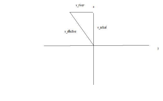

Vector diagram with a horizontal arrow labelled v_river at top, a vertical arrow labelled v_efective pointing down, and a diagonal arrow labelled v_actual joining them.
voko said:
Can you solve it now?
I presume this is in response to part (b) and that part (a) is correct.
As for part(b), I'm not too sure. The question is asking what significance is there if the velocity of the flow is > than the actual velocity. Is it even possible for any of the two lengths in a right angle triangle to be > than the hypotenuse?
How can part (a) in #1 be correct, if it assumes that the effective velocity is the hypotenuse?
