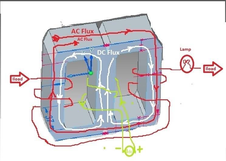

Interesting. Ok so it probably is a rule-of-thumb.jim hardy said:i'm catching up
back to my ladder now
What about in #325:
tim9000 said:"But what I'm asking is, is THAT the actual mechanism by which Steiner designed his Amp to operate, the operation principal of the amplification: it is the force that pushes it the flux down, and allows him to bring it back up again, restorting dΦ/dt to block the current off?"
I then attempted to clarify with:
"When I asked is the DC component the force/mechanism which Steiner's Amp works by, what I mean is:
[oh I got our defined convention wrong, so the rectified AC supply excitation, which drove it into saturation was UP, not Down, ok sorry about the confusion] so keeping in mind the control DC moves the flux back down below zero, so the flux can swing fully up and down the linear region to block the current. 'Would Steiner's Amp have worked if there was no DC component present in the rectified AC supply? that is to say, the dc component is a happy coincidence in the operation of the design?'"
And #326:
Because I know Idc and presumably Ldc = Number of control turns*flux through centre / Idc (which means in the E the Idc would cancel) and Iac shouldn't be a problem. Since flux from an AC excitation isn't constant, does that mean when we talk about inductance, were're talking about the RMS value of the above L and/or E equations? Presumably the values of current we use in them is RMS.tim9000 said:But this re-begs a previous question of mine, which is will the AC RMS B modify where my RMS B point is, or will it theoretically cancel out leaving RMS B to simply be the B from the control winding? What do you think?
And also the notion of inductive energy as E = 0.5*LI2
how will the DC current effect the total Energy of the reactor? Because the inductance L is seen by the AC circuit, but they're sharing a core, hence there is a contribution of DC energy in the total inductance. Say I could measure E directly, then to find L seen by the AC circuit, I assume I'll need to subtract the DC energy out, rearrange something like:
E = 0.5* [Lac*Iac^2 + Ldc*Idc^2]

I'm having difficulty conceiving of a rectified AC supply without a DC component... so I'm struggling to formulate an answer
if you remove the diodes to remove the DC coponent it's still a saturable reactor...
Adding diodes so it'll self saturate means that instead of having to drive it into saturation with control current, you have to hold it out of saturation with control current. The circuit is arranged so it'll naturally saturate.
Load current in a saturable reactor tends to unsaturate part of the core on alternate half cycles.
That's maybe negative feedback, or at least neutral.
Adding diodes makes load current not alternate directions anymore, and drives the core toward saturation. That's positive feedback and positive feedback always increases gain.
Okay that said I'm having trouble with the concept of a RMS point.
load 's DC component pushes us to right
load's AC components sweep flux back and forth.
Control pushes us left, in a tug-of-war with load.
I'm confused again
instantaneous energy is calculated from instantaneous current
AC through an inductor causes energy to cycle between inductor and source so it averages zero
so i'd say the energy stored in the inductor is sum of the energies from DC currents, that is DC components of the load and control currents.
Sorry to seem vague but I'm having difficulty grasping the question.
hope the above is all true. Time for me to get back to my ladder. Check my logic.

i'm at risk of mixing AC and DC again.. Control winding can have AC current if it's not driven by a true current source, and AC fluxes will add in the core according to amp-turns from both load and control windings...
In that circuit above, Steiner's, the AC component comes from those terms in the Fourier on right side of the summation sign.
Now this is sneaky
When the top diode is forward biased and load current flows through upper coil, traveling upward
what voltage is induced into top transformer's control side winding ?
NdΦ/dt i suppose, and how big that is depends on how saturated we are.
By KVL that AC voltage is impressed across series circuit of bottom transformer's control winding and the control source impedance, and it divides between the two.
Look carefully at the polarities.
Top of upper load winding must be positive at that instant
so bottom of its control side winding is driven negative
which both opposes control current
and applies some voltage to bottom transformer in the direction negative on top, which is the direction to saturate it.
The degree to which this happens is a function of control source impedance.
A highly compliant control winding source(like one with a big filter capacitor) let's all that control side AC voltage appear across the bottom winding
A "stiff" true current source will hog that control side AC voltage
So on alternate half cycles the two transformers are interacting in a manner to further saturation.
The control source impedance affects the degree of that interaction, Reyner makes that point...
and that's why i asked along time ago what was nature of your control source.
EDIT if I've not made another blue blunder...

okay i think i finally grasped this question
you're back to the definition of inductance L = NΦ/I which is a great place to start ! I never thought about it in terms of AC
but it has to hold.
Sure, if I is a function like sin(wt) so is mmf, and inductance will be NΦ(wt)/I(wt)
now to get my alleged brain around those "above L and/or E equations " ...
aha E in them is energy not EMF...
Energy = half LI2 is true at any instant for instantaneous current and instantaneous energy
but i don't recall ever being asked to figure the steady state energy stored in an inductor with AC excitation.
So the concept is foreign to me.
An inductor consumes no energy just shuttles it back and forth to source.
It only stores energy for a fraction of each line cycle
Steady State Power = VIcosΘ, by that metric the energy is zero
Now --- half LI2 should be a measure of the energy that's shuttling in and out of the inductor
but how much is there depends on what instant in the line cycle you look at it.
And that's what i'd have to tell anybody who asked.
To speak of a steady state number for stored energy in an inductor excited with AC is to me a misleading thought , for it infers there is some.i'm kinda lost. Maybe somebody will chime in .

Really Sorry I must have sounded mad for two reasons: I may have let the maths make me lose site of the physical setup, because I realize now strange what I was asking sounded (may well still sound that way) What I meant was is that 2/π component here -->
the cause of the self-saturation, or just a happy coincidence? (If in some hyperthetically magic way, would Steiner's work without the 2/pi but still with the other even harmonics?) Hopefully that is a bit of clarity to my madness
The other reson is about the RMS B: Just to be clear, when I ask this I'm referring to my saturatable reactor, not Steiner's mag amp. I also should have clarified that I mean, in practice the point on the BH curve swings up and down due to the AC excitation, so when I meant RMS B, I mean the B point at the value when the excitation was equivilant to the RMS of the excitation.
Because the position I'm in regarding what I just mentioned and what you said about the equation works for instantanious energy but you don't know about steady state energy, is that my tutorial gives the energy given by the simulation according to this:
Thanks!
How does the load have any dc component, if it's just light bulbs? So I see that the AC will want to go up and down, but why would the control push left? Unless you mean Steiner's Amp? Because mine would only push up into saturation wouldn't it?jim hardy said:load 's DC component pushes us to right
(Hmm yeah that's right, back and fourth to the source) You're not being vague, I understand it is hard to know what I'm talking about. So my simulation will likely give me a number for the amount of magnetic Energy stored in the core, whether it's RMS or instantatnious I don't know yet. But the point is that there are two separate coils effectively in the analysis. One is the control coil which is fed by DC, the other is the 'two 200 turn coils' fed by the AC. But both I assume will be contributing to the Energy the simulation calculates is stored in the core, however it is only the AC inductance I am interested in, which is from the perspective of the AC circuit, so I assume I'll need to factor out the DC energy that is also present in the core. For me to calculate the inductance Via the Energy I only want to do it from the AC circuit perspective. Does that explain my position a bit better?jim hardy said:I'm confused again
H'mm so it's true for instantanious, but why couldn't we say use the RMS current, (this is working backwards a bit but) calculate the L by the RMS flux, then get the RMS Energy?jim hardy said:Energy = half LI2 is true at any instant for instantaneous current and instantaneous energy

Back to my design, not Steiner's:
would we do that using ΦRMS and IRMS? BRMS point on the curve is what I called the B at the rms excitation voltage.
So since E = 0.5* [Lac*Iac2 + Ldc*Idc2] Because I know Idc and [if the AC flux cancels in the centre leg) presumably Ldc = Number of control turns*flux through centre leg / Idc (which means in the E the Idc squared would cancel) and Iac shouldn't be a problem.
To get the inductance seen from the AC circuit: So I can rearrange for Lac = [2*[total Energy] - NcontrolΦdc*Idc] / Iac2 ?
Ah, nice realisation. So back to the flux swinging up and down the BH curve on the AC cycle, that point where we say L = NΦ/Ijim hardy said:maybe if i spend more time on the ladder it'll elevate my thought processes...

tim9000 said:h, nice realisation. So back to the flux swinging up and down the BH curve on the AC cycle, that point where we say L = NΦ/I
I believe so. True RMS includes DC...
BRMS point on the curve is what I called the B at the rms excitation voltage. logical...
So since E = 0.5* [Lac*Iac2 + Ldc*Idc2] again logical **
Because I know Idc and [if the AC flux cancels in the centre leg) presumably Ldc = Number of control turns*flux through centre leg / Idc logical
(which means in the E the Idc squared would cancel) i don't follow
and Iac shouldn't be a problem. but let's continue anyway
So I can rearrange for Lac = [2*[total Energy] - NcontrolΦdc*Idc] / Iac2 ? Algebra looks right wrt ** above.
And you said in 326
tim9000 said:Say I could measure E, then to find L seen by the AC circuit, I assume I'll need to subtract the DC energy out, rearrange something like:
E = 0.5* [LacIac2 + LdcIdc2]
now i see what you were up to waaayyy back there.
Told you I'm a plodder. I flunked Line Dance class - couldn't master Texas Two Step.
tim9000
- 866
- 17
I just meant that one of the Idc's in the Idc2 would cancel due to the Idc in the denominator in the definition of inductance.jim hardy said:And you said in 326
Ok Great, so if you think my reasoning for the ac and dc inductive energy components in the reactor core is sound, then I'll use it to try and calculate the ac inductance in the simulation.
What did you think about:
tim9000 said:Well kind of forget about that for a second, say you weren't applying any control current and the 2/pi was magically gone, would the thing still self saturate? And to what level, what I'm assessing (for no reason other than curiosity) is how important that 2/pi is to the operation of Steiners design)
Also to arc right back to when we were discussing how to get the impedance of the amp:
so a brief comparison of our methodologies is that to find the impedance of the reactor you'd use a graphical tangent to the RMS B point on the BH curve, whereas I take the data of the BH cureve, write a formula to interpolate a corresponding B or H value as required to give me an approximate permeability at that point, which I then use to calculate the impedance. They're just two different ways of doing the same thing?
Did you have any thoughts on this point? And I can't remember, did you think that any V.s/N on the two 200 turn coils would make any difference to the impedance of the reactor? Or is it due to the layout that they simply cancel each other out and the impedance is only left being determined by the DC magnetic field density?
Cheers Jim!

here's 326:tim9000 said:I just meant that one of the Idc's in the Idc2 would cancel due to the Idc in the denominator in the definition of inductance.
how will the DC current effect the total Energy of the reactor? Because the inductance L is seen by the AC circuit, but they're sharing a core, hence there is a contribution of DC energy in the total inductance. Say I could measure E*, then to find L seen by the AC circuit, I assume I'll need to subtract the DC energy out, rearrange something like:
okay my conundrum was -
your math looks good
it's an approach i never thought of, figuring L from Energy
*Can you measure energy in the core ?
Homework Helper
Dearly Missed
- 9,864
- 4,896
tim9000 said:Also to arc right back to when we were discussing how to get the impedance of the amp:
as best i recall !
I think that's a "small signal" method
i think yours gives a large signal measurement; more like this?
what do you think ?
I don't understand that question.
hmm we're speaking of this arrangement ?
again, reason it by taking to extremes
1. Zero DC flux, adjust AC source voltage - impedance is fairly constant at flux below saturation where slope is constant, see above second BH curve shortest red tangent (which i should have numbered 1.) .
Upon reaching saturation impedance drops as on tangents 2 and 3. Remain aware it's a non-linear device then because current departs from sine shape.
So yes, V.s per turn affects impedance, and applying enough V.s per turn effects a precipitous drop in impedance !
2. So much DC that core is utterly saturated -
now you're not sweeping flux across zero anymore, you're operating out on a wing like upper BH curve ?
