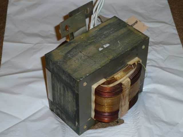

For example, here's a transformer from a 4000 watt sine wave inverter:
This transformer has 12 watts of core loss at no load, and at full load. The copper loss at full load is about 200 watts. The reason for this disparity is that customers seldom run their inverters at full load, and they want very low no load and light load losses, core and copper combined. The no load losses determine how fast your battery will run down when only the nite lite is being powered.

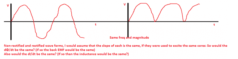

I think I have a better way to pose my question about whether the dΦ/dt of a rectified mag amp or one that just sees both parts of the AC supply makes any difference:
I know rectifying it is better from the stand-point of no magneto-striction, but I was wondering if there were any magnetic down-sides? So to speak.
Rectifying just flips the negative half cycles
so slope at every instant has same absolute magnitude in both waves
from 0 to pi radians the waves are identical and have same slope
but note from pi to 2pi, slopes have same magnitude but opposite sign
so would it be rigorous use of language to say dΦ/dt was same for both waves?
RMS of both waves would be same, presumably any function that squares would give same result for both waves
but i'd be very cautious about claiming "same" dΦ/dt for them.

tim9000 said:
So are you saying if you supply a mag amp with rectfied ac, the fundamental will make it's reactance twice as large??
be careful with that thought.
Look at Fourier of full wave rectified sinewave
http://www.reed.edu/physics/courses/Physics331.f08/pdf/Fourier.pdf
rectifying your sinewave it changes it from a plain single frequency to a summation of even harmonics
and the line frequency fundamental disappears !
So your AC meters measuring V and I are going to see that summation...
Impedance at each harmonic is jωL at that frequency
but remember a real core has frequency dependent losses(eddy currents) , so L itself if a f(frequency)
so Z will be larger but 2X larger would be a fluke.
Not meaning to be difficult or contrary, just be careful about taking too big leaps of thought.

So then when you rectify it, the supply becomes the sum of the even harmonics, so how does that change the dΦ/dt for each hump? I imagine it would increase it?
Yeah I can see they'd have the same RMS. I'm really interested in 'dΦ/dt' because of the implications on Inductance.
So from pi dΦ/dt is negative, and from 2pi dΦ/dt is positive, so for instane in the equation E = NdΦ/dt
what implications does this positive only (due to rectification) have on E?
i guess i was looking at slope of voltage...
dΦ/dt IS voltage (per turn).
so dΦ/dt also becomes the sum of even harmonics
what does that series evaluate to ? I think it'll be less than 1 so dΦ/dt decreases a little ?
Thanks
E an dΦ/dt are one and the same, scaled by NTurns ?
