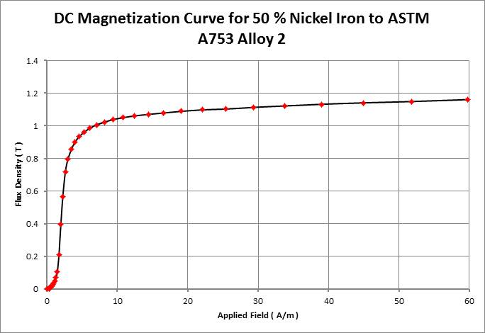

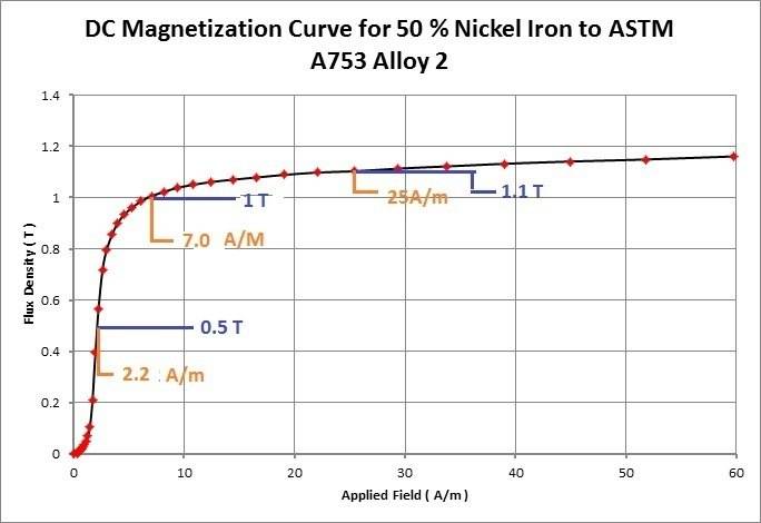

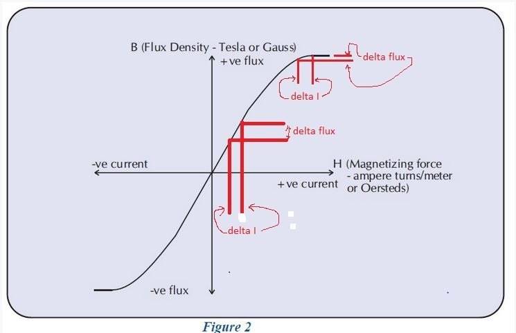

Hi all, thanks for the replies.
On your curve I'd say it'd be at zero, but I was thinking more of a BH curve like this:
https://upload.wikimedia.org/wikipe...Permeability_of_ferromagnet_by_Zureks.svg.png
Where the point would be μmax
Ok using the model (with Rp and Xp still present):
https://www.physicsforums.com/attachments/transformer-jpg.84964/
So using that BH curve at the point of μmax, with respect to: LM= μN2A/Length = N2/reluctance
Assuming we had some arbitrary constant cross sec area and number of turns, then μ is higher than when opperating at the knee point,
So I'd conclud that the inductance Lm is bigger and so Io is smaller. But since also Lm = Φ*N/Io than for the dependent variable:
Φ = Lm*Io/N
I'm not quite sure if this stays the same or not? (Given Lm has risen and Io has shrunk) So I can't really compare how the TX differs from use at the knee point...maybe I'm just tired atm...(packing boxes to move/tending to yard all day)
Could you please elaborate on 'small signal performance'? Sounds interesting: By incremental flux do you mean like the rate of increase of flux? (but by 'large signal' do you mean like the end result peak flux?)
Do I interpret you correctly as: 'As long as the primary Vp sine excitation is constant, there will be a (90o lagging) sineusoidal flux of constant maximum amplitude and frequency, regardless of secondary load'?jim hardy said:Volts per turn would be constant VP/N ... and for sine waves that's constant flux. Well, as constant as VP is...

My use of the word slope is due to my lack of technical discipline/awareness.The Electrician said:You're speaking of a "slope". When such words are used, it's usually in a discussion about "small signal" performance.
Yes, when the slope of the BH curve is steep, the incremental flux will be largest there, but not the overall ("large signal") flux.

tim9000 said:Do I interpret you correctly as: 'As long as the primary Vp sine excitation is constant, there will be a (90o lagging) sineusoidal flux of constant maximum amplitude and frequency, regardless of secondary load'?
Yes, look at your model that is the magnetizing current IM .
tim9000 said:but I was thinking more of a BH curve like this:
tim9000 said:So using that BH curve at the point of μmax, with respect to: LM= μN2A/Length = N2/reluctance

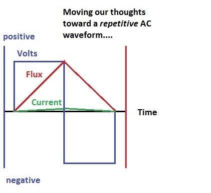

What i think is the point of confusion comes from imprecise terminology in the industry.
A transformer core doesn't operate " at " a point on the curve.
That is a DC curve and only shows one quadrant.
The transformer flux is a sine wave swinging between some positive and negative value of flux every line cycle.
In my BH curve that'd be upper right and lower left quadrants.
Yours omits the lower left, so just imagine it's there.
Flux swings from above to below the horizontal line, mmf swings left and right of the vertical one, at line frequency.
When we say a transformer is operated "at" certain flux we usually mean that's the peak flux. value.
Flux is a sine wave with that peak value.
So the core is operated not "at" but "out to" those two peak values, and flux crosses every point in between them 120 times a second.
Flux 'walks the line' , the gray one, crossing all points between its peak values twice per line cycle ..
The blue permeability line in your BH curve is just slope of the gray flux line, as electrician noted.
Its purpose is to demonstrate iron's nonlinearity
which is why magnetizing current gets that pesky distortion as flux traverses the knee.

tim9000 said:But the question was relating this to the opperating point on the BH curve, I suppose what I was eluding to is that if you're opperating further back down the left side of the curve is Io smaller?
You're not operating at a point you are operating between two points positive and negative peak.
In most power transformers those points are symmetric about zero.
Variations in incremental permeability will more affect the shape of magnetizng current than its amplitude..
Its amplitude is set primarily by how far out the B axis you push the core.
A search on "Barkhausen effect" might help cement the B-H curve in your mind.

tim9000 said:Ok, so the knee point is the peak flux point, it doesn't really opperate there. So does this mean that the famous Xm we've been talking about is the peak magnetising impedance?
I'd say the mean..
You're getting there.tim9000 said:Right so about the whole "peaky distorted" magnetising current when it goes nonlinear: so the flux will have a nice sineusoidal shape up as we run up (or down, +/- quadrants) the BH curve, because BH is kind of linear there and in a linear core the flux will have the same shape as excitation supply? But when the flux wants to follow the shape of the supply (90 deg lag) but it can't because the core is saturating, the flux sort of flattens off.
I'll be keen to hear your (always appreciated) response/evaluation of my development.
Back to stepwise thinking.
What have you selected for your independent variable? The one you control ?
I like to use voltage.
"it" meaning the BH curve, so each incremental bit of flux beyond the knee requires a disproportionate amount of magnetizing currenttim9000 said:Right so about the whole "peaky distorted" magnetising current when it goes nonlinear:
If we chose voltage for our independent variable then flux must equal itstim9000 said:so the flux will have a nice sineusoidal shape up as we run up (or down, +/- quadrants) the BH curve,
Have you leapt again ?tim9000 said:because BH is kind of linear there and in a linear core the flux will have the same shape as excitation supply?
"excitation supply" voltage? Their respective shapes are set by math - derivative function.
If the core is linear, MMF will have same shape too because reluctance is constant.
MMF is amp turns. So the the BH curve sets the relation of current to flux , not the relation of voltage to flux.

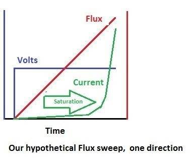

Again, what did you start with as independent variable?tim9000 said:But when the flux wants to follow the shape of the supply (90 deg lag) but it can't because the core is saturating, the flux sort of flattens off.
In ideal inductor(or transformer) Flux and Voltage must keep that derivative relationship.
When the core begins to saturate , more magnetizing current must flow to push flux through the core which is becoming increasingly reluctant to accept it.
Again you have switched independent variables on me - from voltage to current to flux and back.

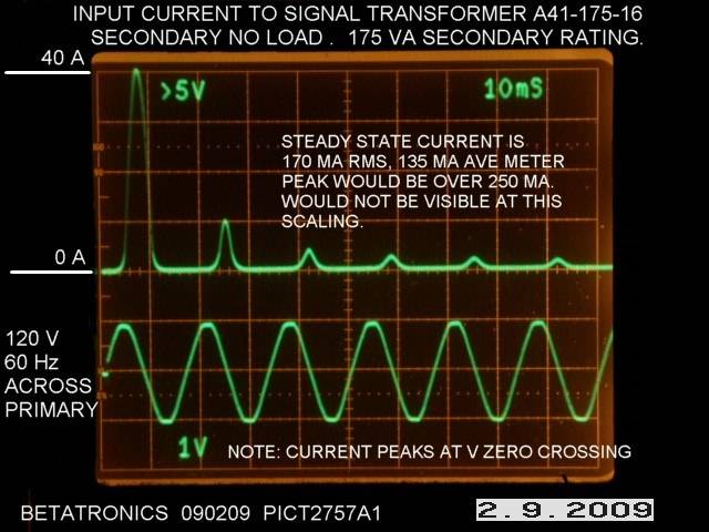

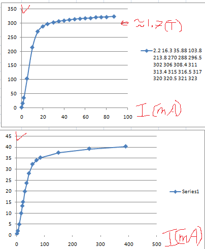

Here's a real inductor with not-sinewave excitation.
Top trace is 20 milliamp peak to peak triangle wave current.
We controlled current as our independent variable.
Bottom trace is induced voltage .
Observe voltage approximates d/dt of current
corners are rounded and top is not quite flat because iron is imperfect - eddy currents and creep(as in barkhausen)
flux was too small to get anywhere near saturation
and this was only 3 hz
It is not clear to the eye that a derivative relation exists when looking at sine waves
this 'scope trace was an eye opener for my technician (who questioned much like you do)
what would voltage do if we reached saturation? Remember we control current...
i think voltage would taper off to zero between current peaks.
because flux would flatten instead of following mmf.
Learn to think in terms of slope - that's derivative...

Derivative action MUST take place, that's Faraday's explanation of what Mother Nature does.
Since in that picture the controlled variable is current which = mmf
unlike the prior setups where we controlled EMF
were i reaching saturation
flux would stop increasing,
hence its derivative would become zero ,

tim9000 said:One other question:
-Do you understand what The Electrician was saying?The Electrician said: ↑
incremental inductance N ΔΦ/ΔI
That type problem is just really tedious algebra .tim9000 said:I gather you didn't really have a differing opinion on that other thread, that's cool.
It's iterative - start combining circuit elements at one end and keep on going.
I gave up beating my head with them .
View attachment 85302That type problem is just really tedious algebra .

no it doesn't look that way to me eithertim9000 said:I see in your picture that the flux isn't a perfect sinusoid,
more precisely, "rather its shape is determined by the BH curve " ?tim9000 said:rather that it has the shape of the BH curve.
The shapes of the BH and flux curves don't look at all similar to me.
The right half of this
is a graphical solution for current required to produce that red flux trace, which happens to resemble a sine function,
though i suppose you also could consider it red flux resulting from application of black currents Ob, Od, Of and Oh.
Only the first quadrant has significance, the other three are repeats by symmetry.
Not at all. Induced voltage and flux must have that derivative-integral relation.tim9000 said:Say you were supplying a perfect sineusoidal voltage: So am I to take it that in a typical ferris core, the flux won't perfectly be the integral of the voltage sinusoid? Instead that it'll be sharper or blunter, depending on how far the flux peaks up the BH curve?
Current is what distorts not flux. E=Ldi/dt and L is not constant with current because relative permeability is not constant.
no no no voltage is always slope(derivative) of flux and you have least voltage aligned with greatest slope
You seem determined to cast out all your prior knowledge and replace it with smooth sounding words.
Lavoisier addressed that tendency in human nature,
The method, too, by which we conduct our reasonings is as absurd; we abuse words which we do notunderstand,recollect, in your case
http://web.lemoyne.edu/~giunta/ea/lavprefann.htmlThe only method of preventing such errors from taking place, and of correcting them when formed, is to restrain and simplify our reasoning as much as possible. This depends entirely upon ourselves, and the neglect of it is the only source of our mistakes. We must trust to nothing but facts: These are presented to us by Nature, and cannot deceive. We ought, in every instance, to submit our reasoning to the test of experiment, and never to search for truth but by the natural road of experiment and observation. Thus mathematicians obtain the solution of a problem by the mere arrangement of data, and by reducing their reasoning to such simple steps, to conclusions so very obvious, as never to lose sight of the evidence which guides them.

I think you're making some assumptions here. The red curve looks like it might be a sinusoid, which it should be if the applied voltage were a sinusoid. But, I don't think Jim intended it to be a sinusoid. You see it as a distorted sinusoid and this has led you to think that the flux might not really be the integral of the voltage.tim9000 said:See I was thinking that the changing relative permeability modified the flux's integral/derivative relationship, but:
If it is current that distorts and not flux, why is the flux of the shape of a BH curve, and not the integral of the sinusoidal voltage?
Let me offer a somewhat different way of looking at the situation.
Consider a 10 ohm resistor. Suppose you apply 10 volts DC to that resistor. A current of 1 amp will flow through the resistor. Suppose you wanted 2 amps to flow through the resistor with 10 volts applied. How could you make this happen? You can't. A powerful way to think about a resistor is to realize that it's a two terminal device which imposes a relationship on the voltage across and current through it. You can't have current and voltage be independent in the resistor.
Similarly, the core in an inductor (and transformer) enforces a relationship between B and H. You can apply a current or a voltage, but whichever one you apply, the other is determined by the core; it cannot be just anything--it is constrained by the core.
So, if you apply a sinusoidal voltage to the winding of an iron cored inductor, the flux is proportional to the integral of the applied voltage, always, no exceptions. Since the integral of a sinusoidal wave shape is another sinusoidal wave, the flux will be sinusoidal also (assuming the resistance of the winding is negligible, which it usually is). What will the current be? It will be whatever is needed to provide the mmf (B) so that the intersection of B and H will be on the B-H curve of the iron core; the laws of physics require it.
Now, if another winding is placed on the core (a transformer now), the constraint imposed by the core is a constraint on the total mmf provided by all the windings.
With an unloaded secondary there will be no current in the secondary; the only mmf the core sees is the primary magnetizing current. Now, suppose we place a resistive load on the secondary. A current will flow which will oppose the primary excitation, reducing the flux in the core. This will lead to less winding voltage due to dΦ/dt opposing the applied voltage, which will lead to increased primary current. To bring things back to equilibrium the primary current must increase so that the total ampere-turns (mmf) applied to the core is determined by the flux applied to the B-H curve. In other words, the primary current increases until its mmf (essentially) cancels the mmf due to the secondary current, so that the effective mmf seen by the core is just the same as that due to the magnetizing current; that mmf is what is required by the flux and the B-H curve.

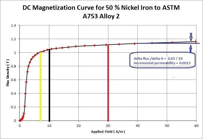

from http://mumetal.co.uk/?p=110
Flux(dependent) versus MMF(independent).
No voltage, no time , no sine, no derivative.
It would be interesting to know how they measured flux at DC.
I've heard it can be done by connecting a good integrator to a winding on the core under study.
That of course gives a voltage proportional to flux. One could have real fun with a current output function generator , integrator and oscilloscope .

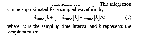

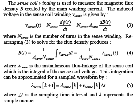

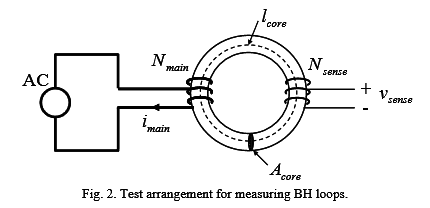

nice little writeup on how they do it with AC
http://www.eleceng.adelaide.edu.au/personal/wlsoong/documents/pebn005BHcurveandironlossmeasurementsformagneticmaterials.pdf
they too use a coil for flux detector
and a DSP method of integration that i don't understand. .

A bigger snip from that link says λ is flux .
and look at their formula... ∫Vsensedt and λsense are interchangeable

I picked this curve because of the units they used.
I wanted to proceed one thought per post
so here goes.
It's a DC curve. That's the place to start developing thought process.
Mu metal is very permeable, used for magnetic shielding.
Horizontal unit on graph is amp per meter,
which is same as amp-turns per meter,
so we can take the small mental leap that it's amps through some particular winding on some particular core of this particular alloy,
made to the specific dimensions such that one amp gives one amp-turn per meter.
That keeps the arithmetic simple. I need that.
let me add to that graph a couple lines representing one thought:
(pardon my awkwardness with Paint)
Let us consider current our independent (controlled) variable.
I apply ten amps and get what, 1.04 Tesla ?
I apply eight amps and get 1.0 Tesla?
Thirty amps gives just over 1.1 Tesla?
Sixty amps gives maybe 1.18 Tesla?
It's nonlinear as we all know.
That's because the domains in the iron align, but there's only so many of them.
Hyperphysics link (Thanks dlgoff)
http://hyperphysics.phy-astr.gsu.edu/hbase/solids/ferro.html
Now
if Inductance is flux linkages per ampere,
which is flux per amp-turn,
is it apparent that for our mu-metal core
inductance would calculate out to a function of current?
amps ...flux ... inductance
8 ... 1 ... 1/8 = 0.125
10 ... 1.04 ... .. 1.04/10 = 0.104
30 ... ~1.1 ... 1.1/30 = 0.037
60 .. 1.18 .. ... 1.18/60 = 0.02
a six to one turndown.
And that's why we operate most inductors below the knee, where our approximation of constant μrelative is close enough .
Observe out beyond 40 amps incremental permeability was 0.0015.
Dividing that by permeability of free space, 4ΠE-7 gives 1194 for μ way out there past saturation
no wonder they call it mumetal

What a delight to see there's still interest in this thread - i was afraid i'd beaten the proverbial horse to death..
so here goes.
