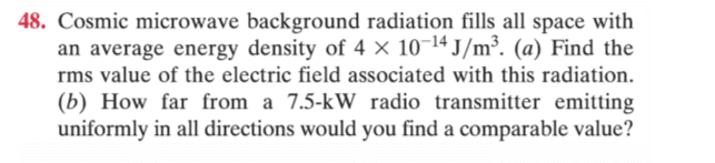

Printed textbook problem 48 on cosmic microwave background radiation: energy density 4 × 10^-14 J/m^3, asking for the rms electric field and the distance from a 7.5-kW uniform transmitter giving a comparable value.
I didnt understand much the question. Should I use, ##υ=εE^2## ? Then I ll take rms value of that E.But I am not sure that is that the max value.Is it max value ? I didnt understand part (B)

You should make an honest effort to show an attempt at a solution. What part of the problem don't you understand? If it's energy density, look here

we didnt see this subject yet..So I am trying to solve the question using just book , and I didnt quite understand.We have energy density and we need to find rms value of E.I wrote like ##u=εE^2## cause it also contains the energy of B-field.So this value is actually used for a instant time.But I think I can take is as a max value of E then ##E_{rms}=E_{max}/(\sqrt 2)##
I didnt understand part b cause I didnt understand what the question wants from us.
First, you missed the factor of ##\frac{1}{2}## in the energy density.
Part (b) asks you to find distance ##r## from a 7.5 kW radio transmitter so that the energy density in a sphere of radius ##r## has the value 4×10-14 J/m3.
