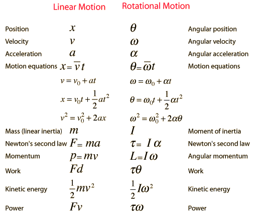

Maybe you should ignore power at first and use torque (T):
(the torque is deemed to be constant)
calculate the acceleration rate (α) in rad/sec/sec
(ive attached a sheet to use)
then calculate the torque T ( in N-m ) from:
T = I * α
( I = flywheel moment of inertia (kg - m^2) , α = rotational acceleration rate (rad/sec/sec) )
With the torque value (T) you can then calculate the power (Watts) at any rad/ sec ( ω ) from:
Power = T * ω
